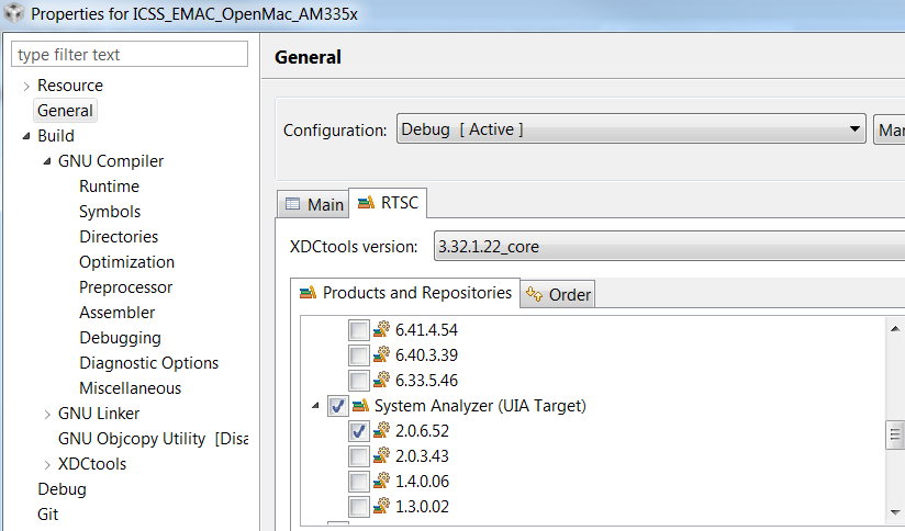

I'm working with AM437x EtherCAT slave demo (full configuration) trying to add CPU Load analysis support, to detect CPU load on TI standard slave and in my current customization.
I've enabled CPU load monitoring on my RTOS configuration (both hardware and software interrupts and task) but, when I run the Load Analysis configuration I see the following error:
For sure I'm missing something but I cannot find any guide to enable UIA instrumentation for this kind of project. Can anybody pointing me to such a documentation?
Kind Regards and TIA
Andrea

  • Hi, could you please double check do you have UIA installed/using? Please check in your CCS project properties
    If not installed, I found this UIA download link. You have to pick an UIA version that works with your CCS version
    thank you,
    Paula
  • Thanks for the quick reply Paula.
    I've manage to install UIA package (uia_2_00_06_52, using bios_6_46_01_38 and CCS 6.1.3) and to include it into the binary (I've added UIA LoggingSetup (add logging setup to my configuration))

  • Andrea, I haven't tried it myself, but from another project (from a colleague) I see CCS configuration file needs to be changed. Below is an example of what you need to add. Of course, if for example you don't want to get graphics for HWI, or SWI and you are only interested in CPU load, then you can enable/disable variables or change size to fit your needs.. I believe for generating CPU load Graph, you need to add Task.enableIdleTask = true
    >>>>>>>> CCS Configuration file suggested additions for UIA>>>>>>>>>>>>>>>>>>>>>>>>
    var LoggingSetup = xdc.useModule('ti.uia.sysbios.LoggingSetup');
    LoggingSetup.loadLogging = true;
    LoggingSetup.loadLoggerSize = 1024;
    LoggingSetup.mainLoggerSize = 32768;
    LoggingSetup.sysbiosLoggerSize = 32768;
    LoggingSetup.sysbiosSwiLogging = true;
    LoggingSetup.sysbiosHwiLogging = true;
    LoggingSetup.sysbiosSemaphoreLogging = true;
    LoggingSetup.loadTaskLogging = true;
    LoggingSetup.loadSwiLogging = true;
    LoggingSetup.loadHwiLogging = true;
    LoggingSetup.enableTaskProfiler = true;
    LoggingSetup.sysbiosHwiLoggingRuntimeControl = true;
    LoggingSetup.sysbiosSwiLoggingRuntimeControl = true;
    LoggingSetup.eventUploadMode = LoggingSetup.UploadMode_JTAGSTOPMODE;
