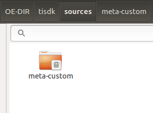

  • Dear Tsvetolin
    Thanks lot for your help.
    I follow your instruct with the process while unfortunately I blocked by the first step.
    When I did the setup , I only see sth like below
    Not the while folder tree as the tutorial .
    Can you help me solve the problem?
    Have a good day.
    Kelvin
