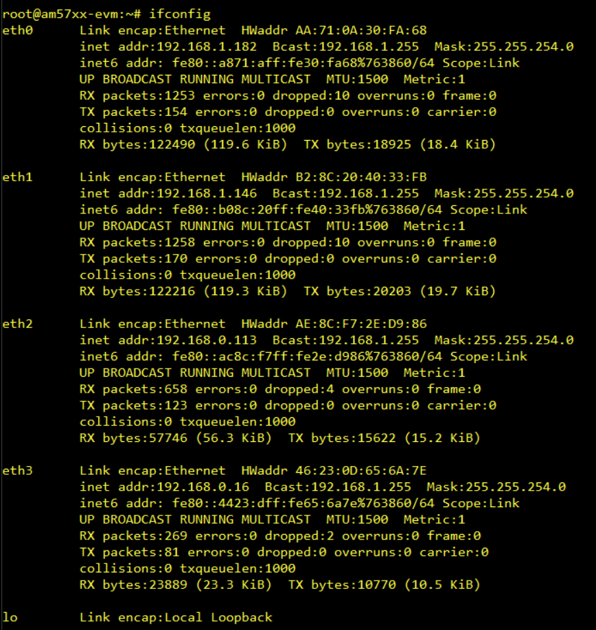

TI, I am using the kernel linux-4.9.41 of the SDK04.01. I want to use the pruss1 to work as two ethernet port just like pruss2.But there are only two ethernet port ,and it should be 4 ethernet port.

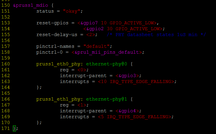

&pruss1_mdio {
	status = "okay";
	reset-gpios = <&gpio7 10 GPIO_ACTIVE_LOW>,
			<&gpio2 30 GPIO_ACTIVE_LOW>;
	reset-delay-us = <2>;   /* PHY datasheet states 1uS min */
	pinctrl-names = "default";
	pinctrl-0 = <&pru1_mii_pins_default>;
	pruss1_eth0_phy: ethernet-phy@0 {
		reg = <0>;
		interrupt-parent = <&gpio3>;
		interrupts = <10 IRQ_TYPE_EDGE_FALLING>;
	pruss1_eth1_phy: ethernet-phy@1 {
		reg = <1>;
		interrupt-parent = <&gpio4>;
		interrupts = <5 IRQ_TYPE_EDGE_FALLING>;

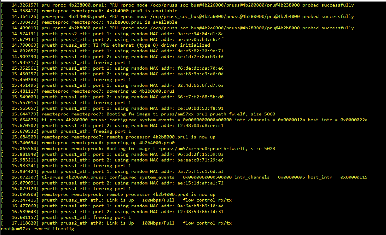

It  works fine on the kernel linux-4.4.19 of SDK03.01. But I should modify the pru_rproc.c,and add the PRU_FUNC_CAPS_ETHERNET to pru1_0 and pru1_1. What else needs to be changed if I use the SDK04.01?

    Some of the PRU Ethernet specific driver pieces (including PRU_FUNC_CAPS_ETHERNET) have been removed from the pru_rproc driver (and moved into the /drivers/net/ethernet/ti/prueth.c driver) beginning with the 4.9 kernel. So, there is no need for you to make that change anymore.
    I took your device tree modifications and booted it on my AM572x IDK board and all 4 PRU Ethernet ports show up when I check ifconfig. I didn't change anything else in the Linux kernel or the drivers, only the dtb. I can't fully verify Ethernet functionality on the additional PRU ports because our AM572x IDK board doesn't make the connections to the PRUSS1 PHY (it connects to the CPSW PHY instead).

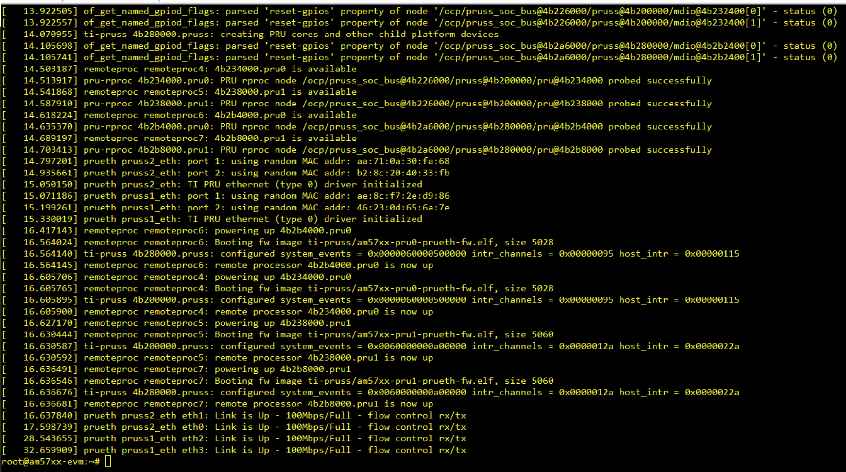

    Looking at your boot log it appears like you are very close except for some reason PRUSS1 port 1 (eth0) keeps getting freed during the boot process. You should be able to track these log outputs in the /drivers/net/ethernet/ti/prueth.c driver and see what is going on during your boot.
    I would suggest removing the changes you made to the pru_rproc driver and then start from there.
    Jason Reeder
    Jason Reeder,after add the pinmux of reset and interrupt pins,it works fine.
