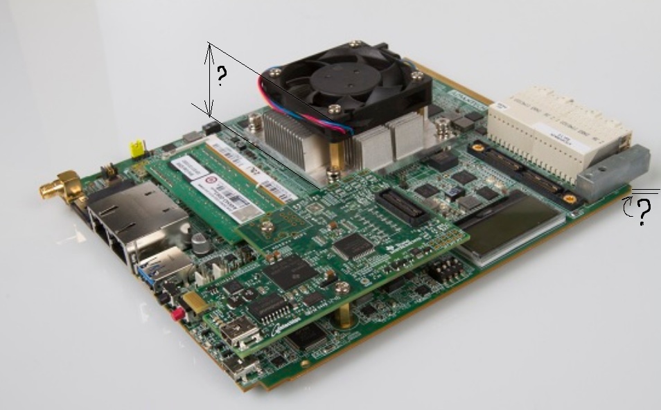

I am making module to plug in this EVM EVMK2HX:66AK2H12, and there are some problems with finding plasment dimensions on MTCA. Can u please tell me how long is it? Also i'd like to know depth of PCB and height of EVM including fan

    I measured the the dimensions which you are asking for:
    1. The slot is 65 mm wide.
    2. Height of both heat slick and fan is 32 mm above the board but some boards have additional metal grid above the fan which adds around 3-4 mm.
    3. The board is 2 mm thick.
