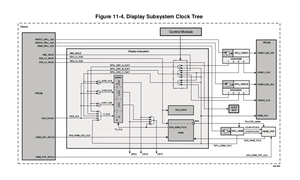

We are using the DRA7xx infotainment processor J6 and the linux kernel 4.4.23.
In addition to the e2e post:
https://e2e.ti.com/support/arm/automotive_processors/f/1020/p/575710/2259260#2259260
and with reference to the figure: Figure 11-4. Display Subsystem Clock Tree, see figure below.
By default the hdmi driver (in the drivers/gpu/drm/omapdrm) is working with this configuration:
F_CLK (multiplexer 1) is sourced from DSS_CLK (DSS_CLK_SRC_FCK)
If we try to synchronize the LCDs using the common DSS_CLK source (instead of the Video PLL lines from DPLLs) and introducing a 'warmreset' before enabling the displays, the time between the 2 Vout HSYNC is ~2ns (see scope figure below).
But with this method the HDMI is no more working.
It is possible to configure the HDMI to use an internal generated clock instead of the default DSS_CLK?
How it is possible?

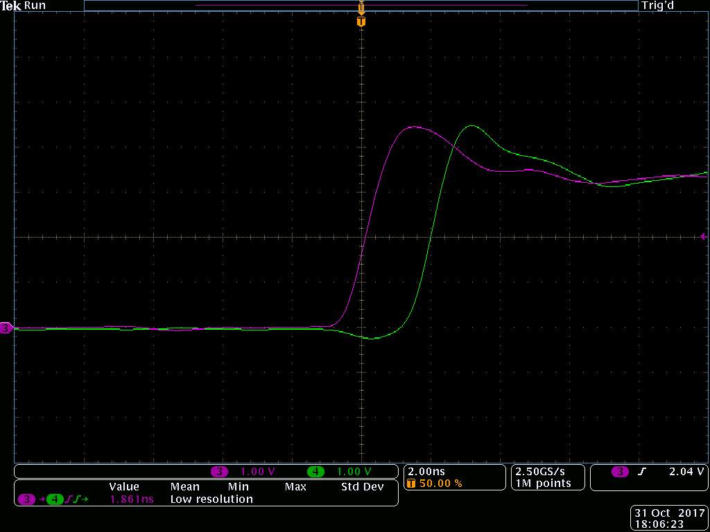

  • To obtain the synchronization between the HSYNC (2ns delay as in the figure above) we used the DSS_CLK as F_CLK source, common to LCD1 and LCD2 and we disabled the Video PLLs:

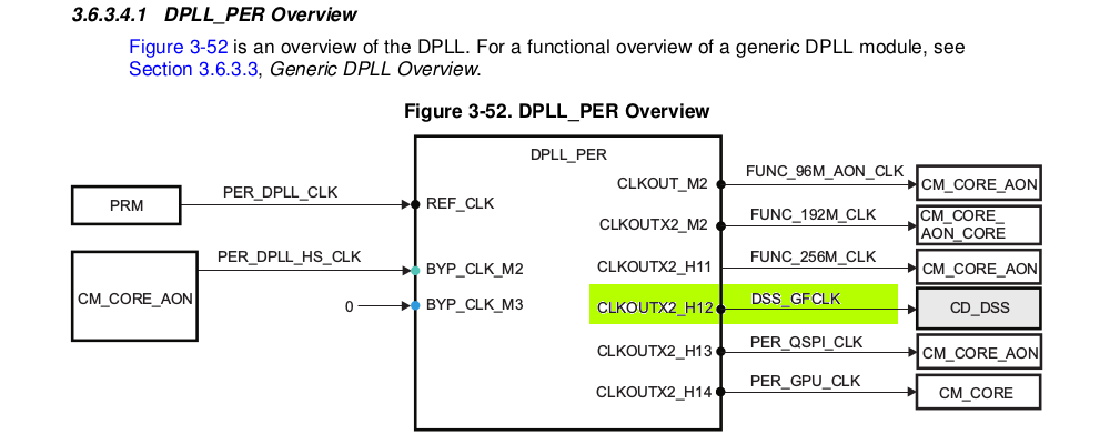

    One difference applying this patch is in the H12 divisor register: CM_DIV_H12_DPLL_PER
    that passes from 0x00000204 to 0x0000020B (change of the DPLL (H12+1) post-divider factor from 4 to B).
    If we force this register to the old value manually,
    devmem2 0x4a00815c 0x00000204
    we obtain that HDMI works but the LCDs doesn't.
    We would like to be sure that this divisor, CM_DIV_H12_DPLL_PER, has influence only on the DSS subsystem or know if this clock signal is important also for other peripherals, different from DSS. This is another important question for us.
    Thank you very much.
    Sorry for the delay in response.
    DPLL_PER HSDIV 12 is only fed into the DSS_GFCLK. This does impact any other IP.

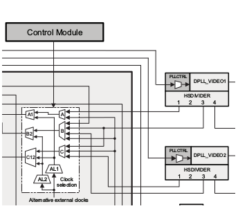

    Instead of using the DSS functional clock, have you considered using the DPLL Video1 HS DIV3 as input to LCD2 and LCD3? LCD3 can be output to LCD1 output if desired using the parallel_sel mux inside DSS?
    regards,
    Venkat
  • Thank you for your response,
    "DPLL_PER HSDIV 12 is only fed into the DSS_GFCLK. This does impact any other IP."
    Ok, Good!
    "What are the pixel clock frequencies that you are trying to achieve for the LCD output and for the HDMI:"
    We have the following ranges from datasheet:
    LCD clock: from 85 to 93 MHz
    HDMI clock: from 32.4 to 41.2 MHz
    "Instead of using the DSS functional clock, have you considered using the DPLL Video1 HS DIV3..."

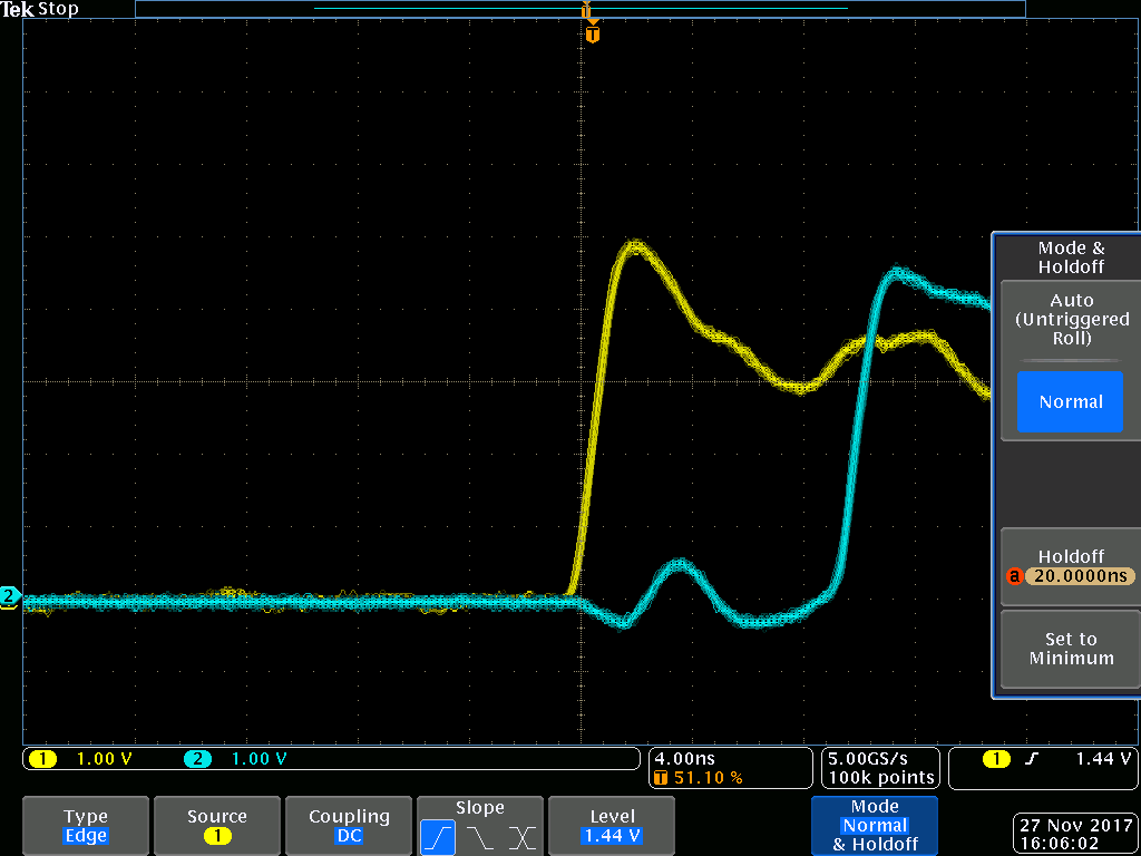

    Yes, this is a solution that we considered also, but from our measurements the LCDs synchronization is not 'stable' and can vary around a range 2-12ns (+ or -, delay between the HSYNCs).
    Than we decided to force the use of the DSS_CLK that is more stable and the delay between the HSYNCs is ~2ns.
    This is a measure whith the Video PLL 1-3 to LCD2 and LCD3, and the mux13/dpi1 set to LCD3 (see the ~10ns delay):

    devmem2 0x4A00815C w 0x0000020B => HDMI doesn't work, LCDs work and are in sync
    Probably (we suppose) having forced the use of DSS_CLOCK for all dpi video LCDs, the driver fails to calculate the correct divisor for the HDMI.
  • Which DRA7 variant will the final product be using?
    DRA7xxP,  the clocking scheme of the DSS is different in the' Control module' (it can take an 'alternative external clock').
    But we canno't use this external source because we don't have it in our schematics, and we don't have the board with the J6P...

  • "One option to check would be to clock the DSS from HDMI PLL instead of the DSS_CLK coming from PRCM, while clocking LCD1 and LCD2 from DSS_CLK. This control is done from the DSS_CTRL register (0x5800 0040)."
    Do You mean to set the register DSS_CTRL bit field F_CLK_SWITCH (bit 9:7) => from 0x0: DSS_CLK selected (from PRCM), default value,
    to => 0x3: DPLL_HDMI_CLK1 selected (from DPLL_HDMI)?
    We don't know how this can be achieved in the DSS (or HDMI) driver (or dts).
    Thank you

    Please look at this patch where Video 1 PLL is used as DSS Functional clock instead of DPLL_PER.
    HACK: use video1 pll as the DSS FCK
    review.omapzoom.org/38748
    With this patch, I verified that the LCD pixel clock can be derived from DPLL_PER HSDIV12 and HDMI continues to function correctly. However I am not sure of how the warmreset would work as the DSS functional clock is now coming from an PLL within DSS.
    Please try this out on your setup first without the warmreset and then with the warmreset.
    regards,
    Venkat
  • Hi Venkat, thank you very much for sharing your patch.
    We verified that applying this patch LCDs and HDMI are working togheter!!
    We made also a test with the warmreset: this is necessary for the synchronization timing of the LCDs (without the warmreset the LCDs are not in sync).
    I think that this patch solves our issue, because in this way the DSS_CLK can be used by the LCDs without affecting the HDMI.
    Now I have to verify the 'stability' of this solution: please give me some day to make other tests before closing the issue.
    Thanks a lot
    massimo
