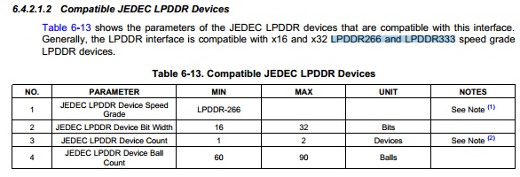

We use below system:
OS:Wince6.0
Processor:AM3715

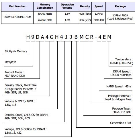

Nand + LPDDR(MCP):H9DA4GH4JJBMCR-4EM
Question:
H9DA4GH4JJBMCR-4EM is LPDDR2 400M + Nand,I read AM3715's spec, It can support LPDDR266 & LPDDR333 ,The table only show MIN speed,
I can not see MAX, Please confirm LPDDR's speed in AM3715 system(Only LPDDR266 & LPDDR333?).Thanks a lot!
H9DA4GH4JJBMCR-4EM:
