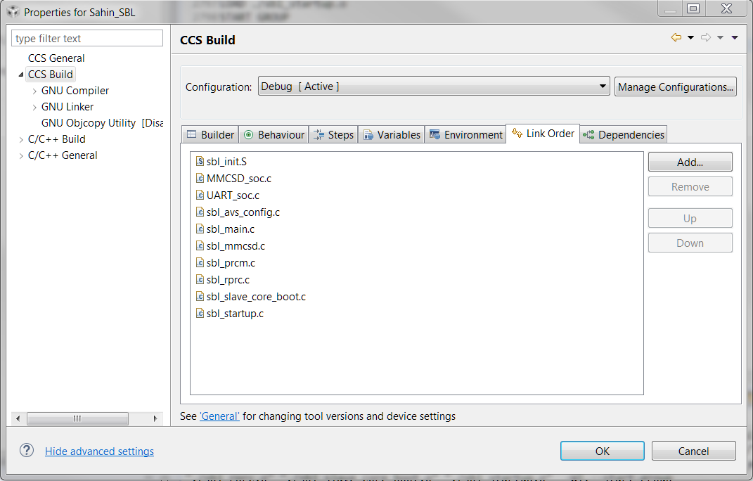

With the help of the forum I was able to port the TI SBL project into the CCS environment.
I can run and debug the SBL code on my idkAM571x via CCS. But when I boot with my generated MLO file (by SD card), nothing happen.
My attempts:
a)
Note: idkAM571x_SBL.out was generated via CCS.
objcopy.exe -O binary idkAM571x_SBL.out idkAM571x_SBL.bin
tiimage 0x40331000 mmcsd idkAM571x_SBL.bin MLO
MLO do not run

  • Christian,
    In your build step, I am unable to see the linker command file that you are using with the CCS project. Can you confirm that you use the linker command file provided at pdk_am57xx_1_0_8\packages\ti\boot\sbl\board\idkAM571x\build
    If you  see that linker command file. that is the file that puts the start_code section at the address 0x40331000 (start of SBL_MEM section)
    you can post your sbl.map file here for us to look at if you are already doing this step.

  • Hi Rahul,
    Yes I think so. The SBL_SRC_DIR points to C:\ti\pdk_am57xx_1_0_8\packages\ti\boot\sbl define in Build/Variables. The linker.cmd has an entry in GNU Linker\Libraries (-T), see screenshot
    Following the map file with the entry:
    2786: .startcode 0x40331000 0x0
    idkAM571x_SBL.map.txt
    Christian
  • From your map file it appears that  the Entry symbol is not at the base of SBL_MEM. A quick comparison between your map file and the one built by makefile shows your startcode section is empty and the Entry symbol is at 0x40331bb4
    I am not sure if the link order is causing this issue but you need to find a way to haave the Entry symbol at the base of SBL_MEM.
    Here is the snapshot in your map file I am refering to ::
    this is what it looks like in the file built using makefile:
    Rahul
  • Hi Rahul,
    If the link order would cause this problem, where would I have to adjust / try something?
    Rahul
    On e2e.ti.com/support/arm/sitara_arm/f/791/t/629312 you can download the SBL project ported from E2E. There is also an address difference between .startcode and Entry...
    Another conspicuousness:
    Generated with gmake, see (LOAD one ao file - the one)

    Do I have to enter the "Common Entry Object" somewhere in CCS? Or does it have nothing to do with my problem?
    Christian
  • Christian,
    Under Build Options -> CCS Build, there is a tab to change the link order. Can you try that option by putting sbl_init.S to the top if the link files.
    We have not tried this option yet but I am working with Sahin who helped you with the original post to see if we can force the compiler to put the symbol at the location in OCMC memory that the RBL expects.
    Rahul
  • We tried the suggestion provided here and were able to relocate the entry to the location 0x40331000. Here are screenshots to help with this setup
    Hope this resolves the boot issue.
