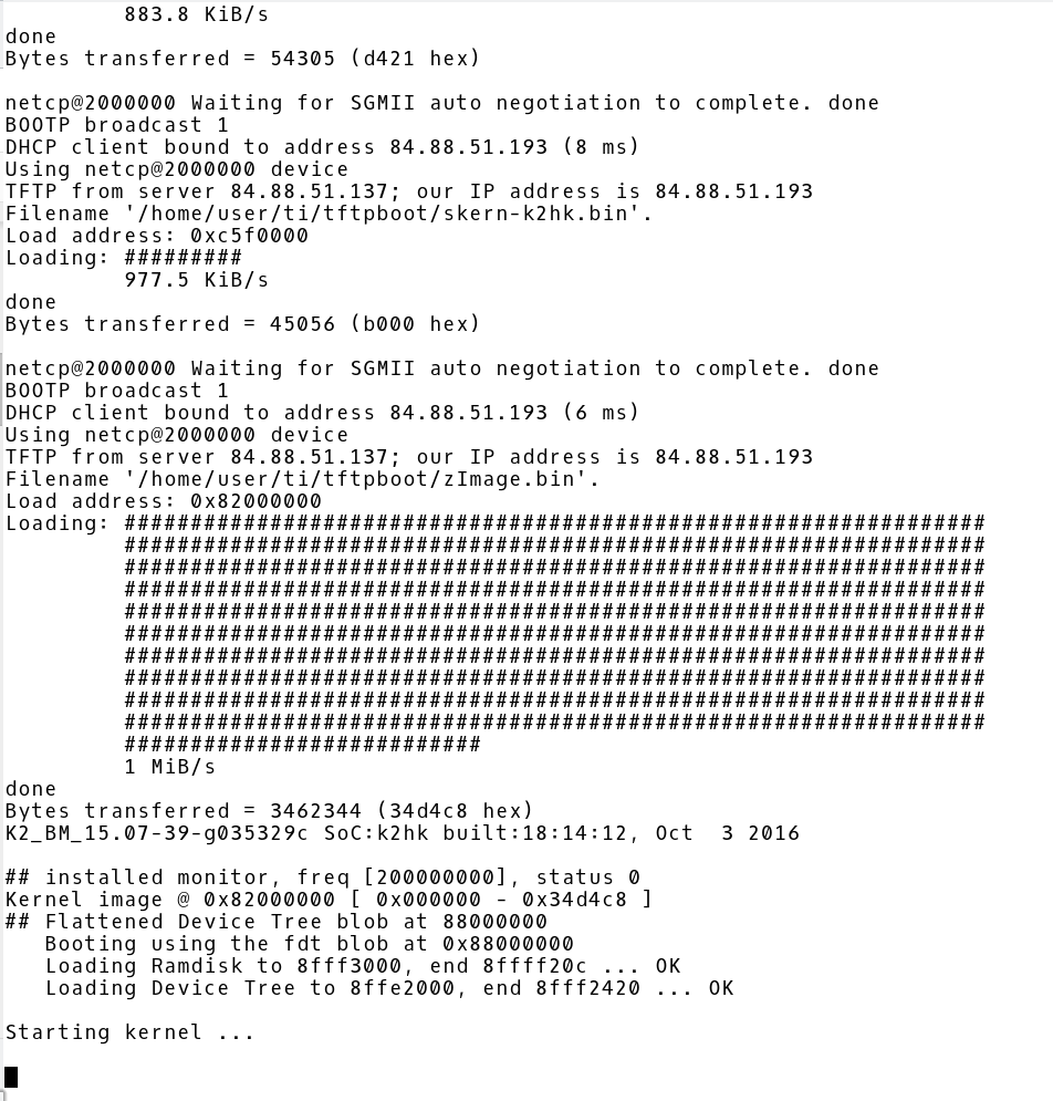

    I have just done what you have suggested like follows:
    1) Add #define DEBUG to /include/configs/k2hk_evm.h
    2) Rebuild uboot
    cd ti-processor-sdk-linux-k2hk-evm-03.01.00.06/
    make u-boot-spl
    3) copy the new generated .gph into the tftpboot
    cp u-boot-spi.gph /home/user/ti/tftpboot/
    4) get it and burn it (succeed)
    U-Boot # env default -f -a
    U-Boot # setenv serverip <ip address of tftp server>
    U-Boot # setenv tftp_root <tftp root directory>
    U-Boot # setenv name_uboot u-boot-spi.gph
    U-Boot # run get_uboot_net
    U-Boot # run burn_uboot_spi
    5) Set up the variables for booting up again
    env default -f -a
    setenv boot net
    setenv mem_reserve 1536M
    setenv serverip 84.88.51.137
    setenv tftp_root 84.88.51.137:/home/user/ti/tftpboot
    setenv name_fdt keystone-k2hk-evm.dtb
    setenv name_kern zImage-keystone-evm.bin
    setenv nfs_root /home/user/ti/evmk2h_nfs
    setenv nfs_serverip 84.88.51.137
    saveenv
    boot
    6) Booting output

    Starting kernel ...
    ______________________________________________________________________________
    It seems to me that uboot is not taking the new changes I did, may be I'm missing something.
    Note that I'm using the USB cable that has SoC UART and MCU UART.

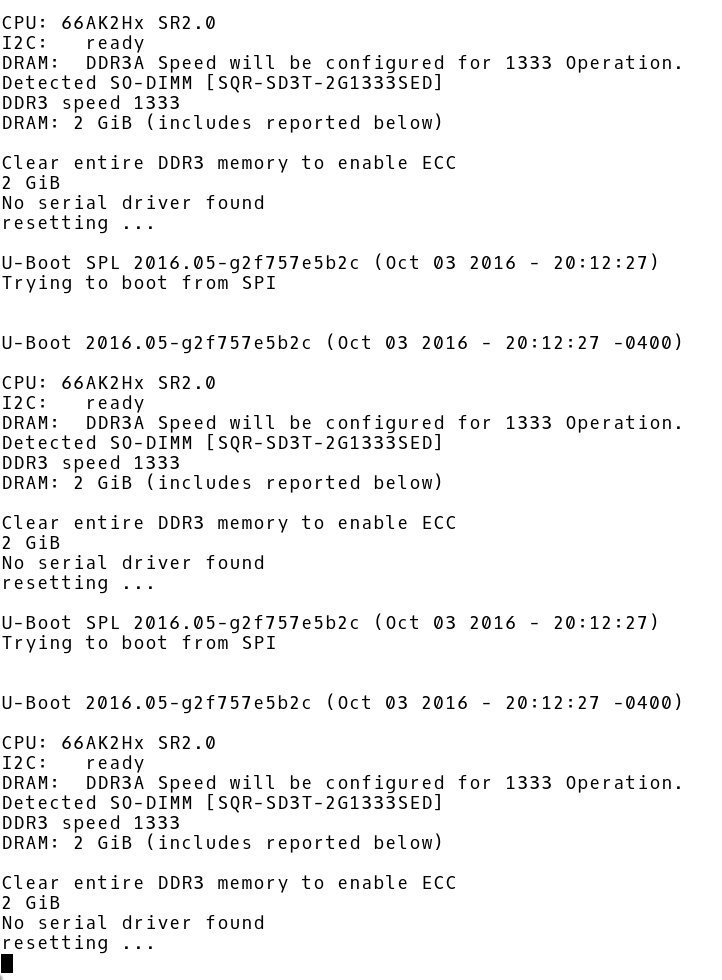

    After freezing at Starting Kernel I rebooted the board and keep getting "No serial driver Found". Each time I need to access the uboot console I have to unplug and plug the USB from the server, otherwise the "No serial driver Found" keeps showing.

  • Here is what seems to be the problem. In u-boot environment you set:
    And then when u-boot starts loading device tree & kernel, it loads:
    Filename '/home/user/ti/tftpboot/keystone.dtb'.
    So the you're in fact using the wrong .dtb file.

    I just tried what you have suggested, It didn't work :(  still showing "No serial driver found"
    In fact when it finished the command "run burn_uboot_spi" the board automatically reseted.
    After this it kept showing "No serial driver found", anyway I also tested the second part you suggested me and all the same.

    Here is the console log you asked me previously.
    I will try what you suggested me and I will let you know.

    U-Boot SPL 2016.05-g2f757e5b2c (Oct 03 2016 - 20:12:27)
    Trying to boot from SPI
    U-Boot 2016.05-g2f757e5b2c (Oct 03 2016 - 20:12:27 -0400)
    CPU: 66AK2Hx SR2.0
    I2C: ready
    DRAM: DDR3A Speed will be configured for 1333 Operation.
    Detected SO-DIMM [SQR-SD3T-2G1333SED]
    DDR3 speed 1333
    DRAM: 2 GiB (includes reported below)
    Clear entire DDR3 memory to enable ECC
    2 GiB
    resetting ...
    CPU: 66AK2Hx SR2.0
    I2C: ready
    DDR3 speed 1333
    2 GiB
    resetting ...
    CPU: 66AK2Hx SR2.0
    I2C: ready
    DDR3 speed 1333
    2 GiB
    resetting ...

  • Hello Rex,
    There you have the log.
    It failed at "sf probe" but before the "print ${filesize}" showed error!
    netcp@2000000 Waiting for SGMII auto negotiation to complete. done
    BOOTP broadcast 1
    BOOTP broadcast 2
    BOOTP broadcast 3
    DHCP client bound to address 84.88.51.193 (761 ms)
    Using netcp@2000000 device
    TFTP from server 84.88.51.137; our IP address is 84.88.51.193
    Filename '/home/user/ti/tftpboot/prebuilt-images/u-boot-spi-k2hk-evm.gph'.
    Load address: 0x82000000
    Loading: #################################################################
            1.2 MiB/s
    done
    Bytes transferred = 537421 (8334d hex)
    => print ${filesize}
    ## Error: "8334d" not defined
    => printenv burn_uboot_spi
    burn_uboot_spi=sf probe; sf erase 0 0x90000; sf write ${loadaddr} 0 ${filesize}
    CPU: 66AK2Hx SR2.0
    I2C:   ready
    DDR3 speed 1333
    2 GiB
    resetting ...
    CPU: 66AK2Hx SR2.0
    I2C:   ready
    DDR3 speed 1333
    2 GiB
    resetting ...
  • That's my mistake. The command should be "print filesize". The failure of "sf probe" command means the NOR can't be accessed. You can try to see if kernel boots using CCS. I am not sure what state the u-boot is without knowing the history. If it is just because a bad u-boot image, you can recover it using CCS to restore it with pre-built image. If it is hardware being bad and you can still boot kernel using CCS, then probably that's will be the way it is.
    Rex

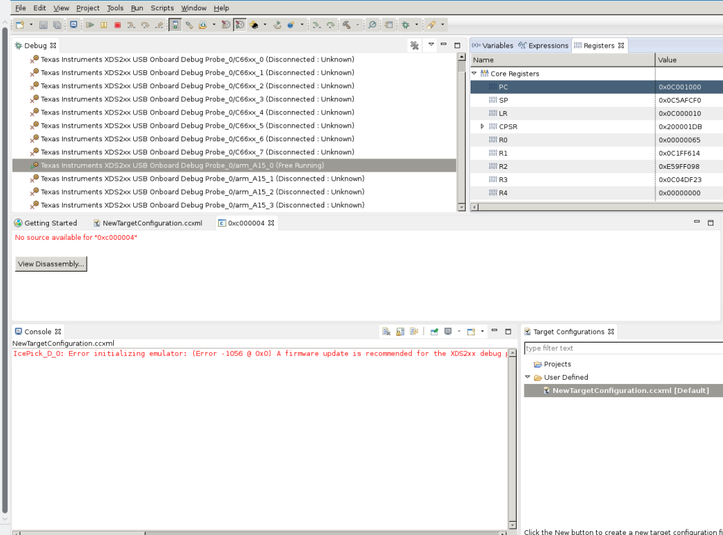

  • Hello Rex,
    Just to give you an update:
    After hard trying because the connection test was not working, I managed to try the first example of the README file. At first attempt it failed when Connecting to the target:
    In the second attempt I managed to run up to the "Free run" step, but I didn't get any output in the terminal console (where uboot was supposed to show up)
    I could not keep trying because the connection is not working anymore through CCS (it stopped working suddenly), I tried rebooting the board, server and the test connection is not working either.
    so I will keep trying and if you have any suggestions please let me know.
    Thank you
    I managed to get the connection working again and tried but no success, I run up to "Free run" step and terminal console did not show anything. just like the last picture of previous post.
  • Hi, Carlos,
    The terminal console you meant is either the minicom or teraTerm, not the console window in CCS, correct?
    Rex
  • Hi Rex,
    Right, that one, The one I access separately of CCS through minicom.

  • Hi, Carlos,
    That firmware update warning message shows up if using a newer version of CCS with an old rev EVM. It does no harm and the CCS should still be able to connect to the target. If it is annoying, you can follow the instruction as indicated in the ReadMe.txt to update the firmware.
    Did you do a connection test before trying to connect to the target? If connection failed, a power cycle or restarting the CCS may help.
    If connection test fails, make sure you follow the instruction to set them up.
    Rex

    I just tried again with the pre-built images but still the same error "No serial driver Found". Should we send the board to repair or check. Or any other suggestions?.
    Thanks a lot
