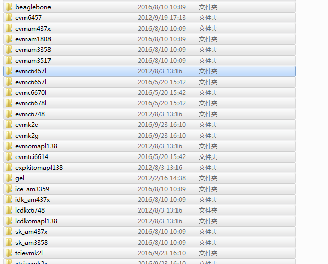

idon't understand .could you tell me how should i do where i find the GEL file?
For your first question, do you have v1.3.6 of the Sitara Device Support package installed as Rahul mentioned? If not, you can update it by following the link in his post (processors.wiki.ti.com/.../Updating_CCSv6)
For your second question, following the link provided (processors.wiki.ti.com/.../AM437x)
Open up command prompt and go to the location of tiimage.exe, for example,
cd C:\ti\pdk_am335x_1_0_8\packages\ti\starterware\tools\ti_image
Then run the tiimage.exe using the format shown below:
tiimage.exe <Image Load Address> NONE <application>.bin <application>_ti.bin
