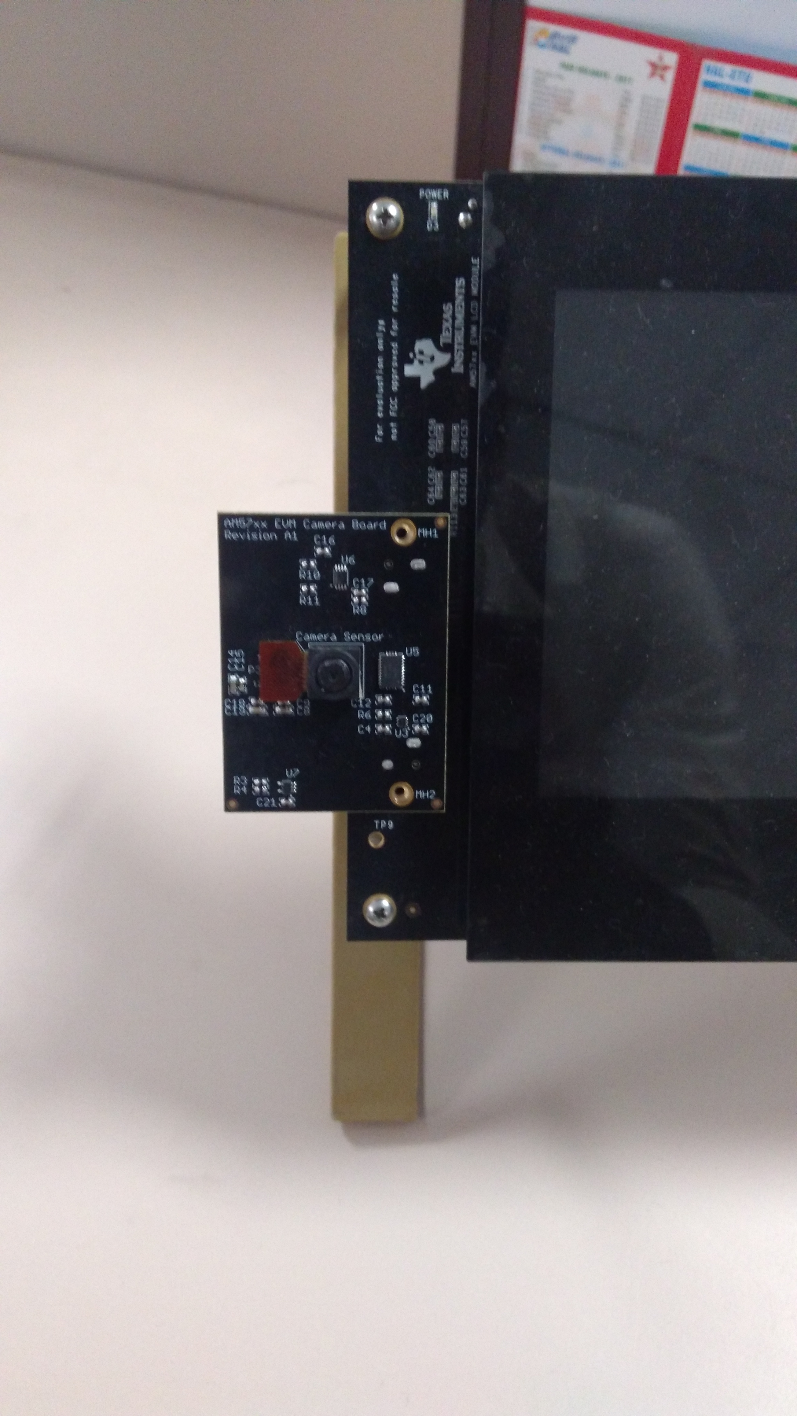

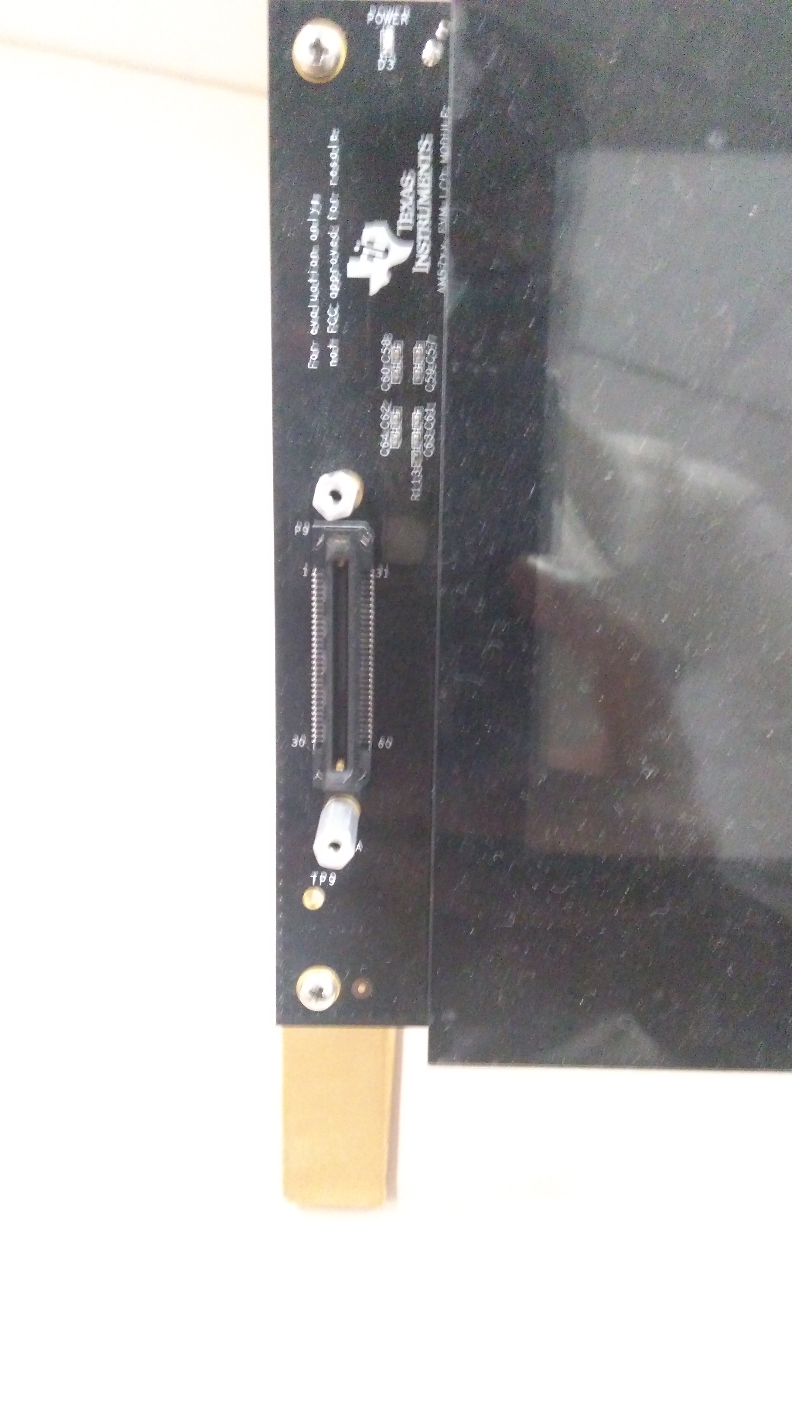

  • Hi manisha,
    We purchased am57xx-evm evaluation board along with lcd module and camera module.
    We connected adv7611 ic pins like hsync, vsync,clock  and data to a connector which mates with p9 connector on lcd module.  (p9 connector on lcd module to which the camera module plugs in).
    Since i am not altering any pin configuration ,I assumed that pinmux is not required as it is already implemented for camera module(vin3a pins made available on p9 connector).
    See pics attached .
    Marka

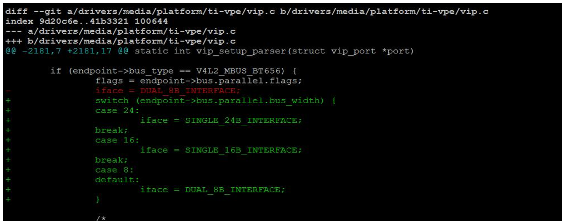

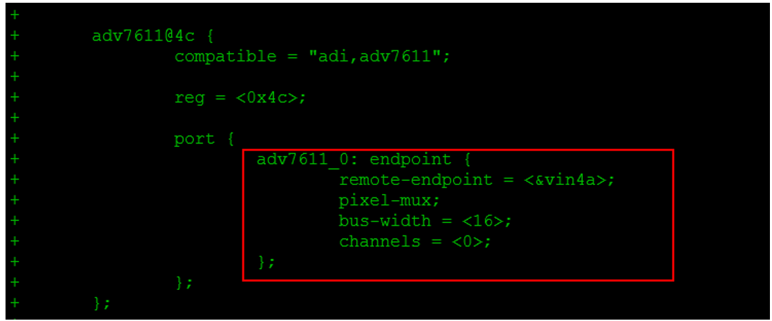

    Marka,I had test the adv7611 on the vin4a port of am5728.I will update the adv7611 driver and dts configuration for adv7611.adv7611 using embedded synchronization mode
    BR,
    vefone
  • The camera connector on AM57x GP EVM board is also controlled by several board mux which are controlled through gpios. If you look at the original am57xx-evm-common.dtsi, you will see something like this -
           mt9t11x@3C {
                   compatible = "aptina,mt9t111";
                   reg = <0x3C>;
                   reset-gpios = <&gpio4 17 GPIO_ACTIVE_LOW>;
                   oscen-gpios = <&gpio5 10 GPIO_ACTIVE_HIGH>;
                   powerdown-gpios = <&gpio5 11 GPIO_ACTIVE_LOW>;
                   bufen-gpios = <&gpio5 12 GPIO_ACTIVE_LOW>;
                   camen-gpios = <&gpio6 11 GPIO_ACTIVE_LOW>;
                   port {
                           cam: endpoint {
                                   remote-endpoint = <&vin3a>;
                                   hsync-active = <1>;
                                   vsync-active = <1>;
                                   pclk-sample = <0>;
                                   input-clock-freq = <32000000>;
                                   pixel-clock-freq = <96000000>;
    In your modified driver, you also need to take care of these gpios the same way mt9t11x.c driver sets them.
    Most probably the signals are entering the camera board but are dying at either board mux toggled by bufen-gpios or camen-gpios.

    dts configuration:
    modify the vip driver:
