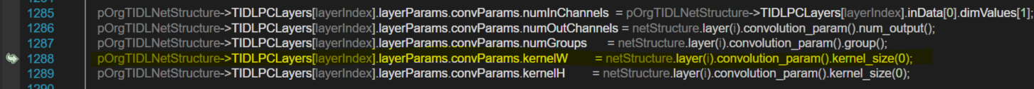

  • About this error,
    I found that it happened when I execute to the function TIDL_importDeconvParams(),
    About my prototxt file, the deconvolution layer, the convolution_param only have kernel_w and kernel_h, but none kernel_size.
    If I changed my code to
    pOrgTIDLNetStructure->TIDLPCLayers[layerIndex].layerParams.convParams.kernelW        = netStructure.layer(i).convolution_param().kernel_w();
    pOrgTIDLNetStructure->TIDLPCLayers[layerIndex].layerParams.convParams.kernelH        = netStructure.layer(i).convolution_param().kernel_h();
    , the error is gone.
    So is there any possible side effect by changing the two lines of codes above? Can TIDL work with non-square kernel too?
