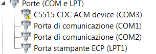

I'm trying to let CSL_USB_CdcExample_Out work on a C5517 device.
I simply open the CSL_USB_CdcExample_Out and change the C5517 define in csl_general.
When I let the program run, I get a USB Code 10 Error on my computer. I installed the device driver using the .inf file provided with the csl library example and I didn't change it!
This is what I see from the control panel:
I tried disintalling and installing it back, resetting the computer and change cable/usb port both ina 32bit and 64bit windows 7 system .
Debugging the enumeration I notice that the last packet sent by the host is a SET CONFIGURATION: after that nothing else happen.

    I did try the test procedure you showed me, but since the enumeration is not properly concluded when I open TeraTerm the COM listed on the "Device Manager" ports is not shown, so I can't open the COM.
    The default .inf file provided by the csl example library is ment for a C5515 device: how should I modify the .inf file if I use a C5517 device?

  • As a new input on my issue, I'm able to corrtectly let the CSL_USB_HidExample work, but still same "Error code 10" with the USB CDC test.
    I'm assuming there is something that goes wrong with the CDC configuration. I tried on a different computer with no results.
