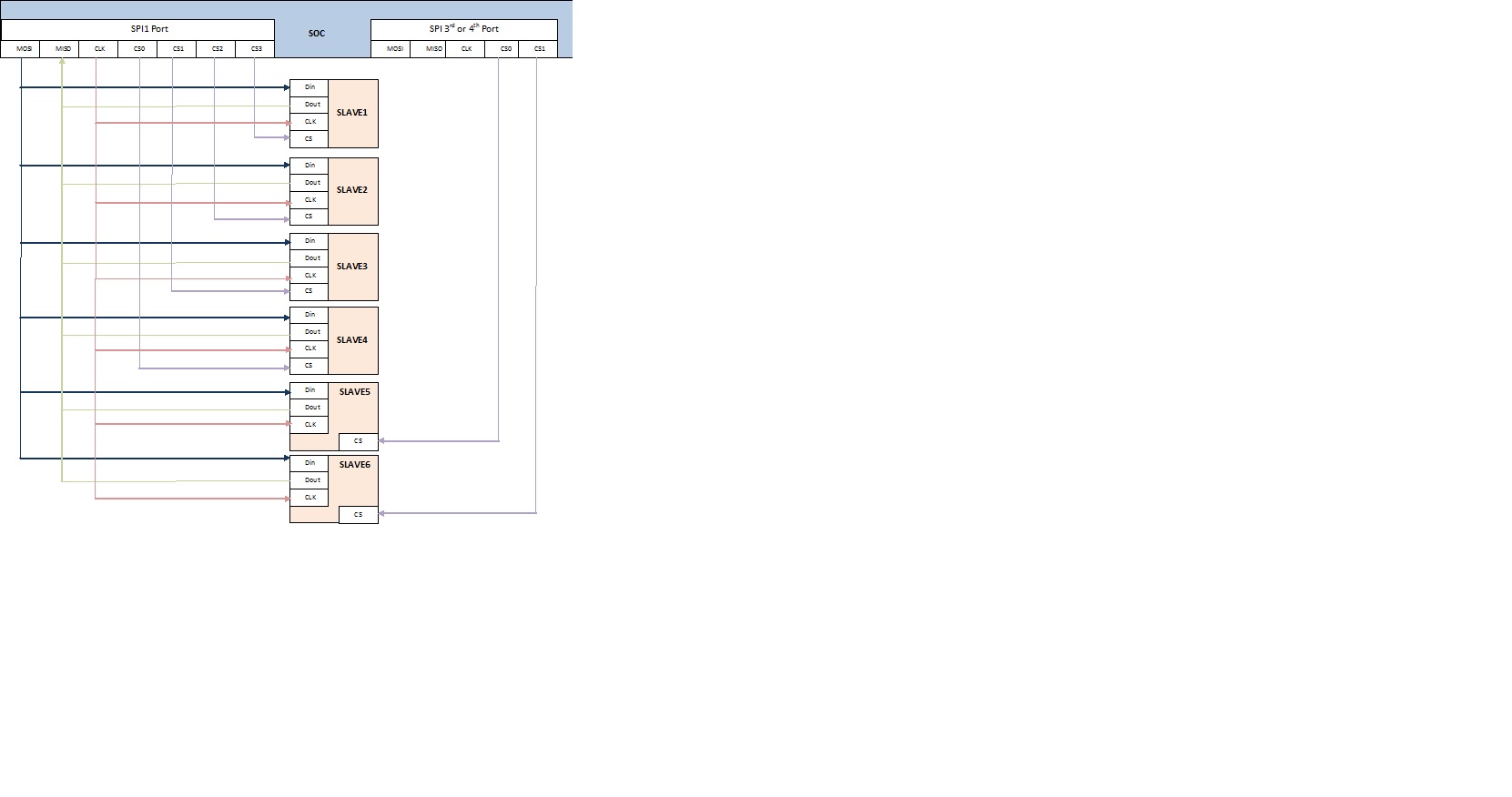

  • Dear Stan ,
      Thank you very much for your reply on drive current for SPI bus. SPI communication between the SOC and slave devices is as follows:
    1. Yes it is a two way communication.
    2. We need to drive 6 slaves at a time.
    3. SOC (Master) will broadcast the data to all slaves at the same time through MOSI line.
    4. Slaves will acknowledge individually to the master through the MISO line.
    We have used 4 chipselect lines for 4 slaves from SPI1 Port of the SOC and 2 chipselect lines will be used either from SPI3 or SPI2 ports of SOC. We are taking data and clock only from SPI1 port. Data and clock lines of SPI3 or SPI4 port will not be used. As per the datasheet details the chipselect lines were also muxed with GPIO pins. In that scenario can we configure chip select lines as GPIO lines to enable the slave device? Please advice.
    I have attached a rough sketch of connection details.
    Regards ,
    Dhanasekar.c
  • Hi Dhanasekar,
    My answers inline.
    3. SOC (Master) will broadcast the data to all slaves at the same time through MOSI line. [Broadcasting is not possible in SPI, you can only access one slave at a time]
    4. Slaves will acknowledge individually to the master through the MISO line. [This is fine if you follow my comment for 3.]
    [TI An SPI hardware  'knows' that it has only 4 CS-es. I'm thinking of one trick to overcome that:
    - You can use first 3 CS-es as usual [CS0-CS2]
    - You must disconnect CS3 from any external hardware (on PCB or via SoC pinmux). In your particular case you can switch (mux) CS3 to a GPIO.
    - SPI hardware will continue to think of its CS3 as of single device, but you (SW)  will do the CS3-CS5 assertions artificially via 3x GPIOs.
    That is, when you need to access devices CS3-CS5, you need to assert the proper GPIO pin, and then, issue a transfer to CS3 of SPI1.
    Those above are only thoughts, I cannot guarantee it will work, nor I do know how the slaves work and their requirements to SPI modes and timing.]
