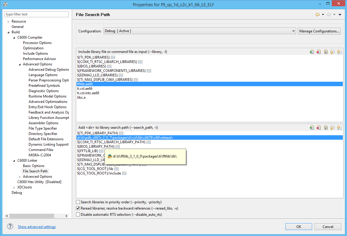

  • Hello Garrett!
    Thank for your reply. FFTLIB v3.1, does not include example projects. I have got some dificulties in re-basing my project to new release because of a lot of FFTLIB dependencies with packages and libs. I think also FFTLIB v3.1 has no significant differences from FFTLIB v2.0. Also I can't find any documents for FFTLIB. Can you give me link on documents and example projects for FFTLIB v3.1?
  • I'm trying to export example project from FFTLIB v2.0 to FFTLIB v3.1. As i wrote above, FFTLIB v3.1 contains no examples. Directory d:\ti\fftlib_3_1_0_0\packages\ti\fftlib\src\fft_sp_1d_c2c\ contains only file fft_sp_1d_c2c.h. It was required to define the variables:
    and connect the library
    While compiling i have got folowing errors:
    unresolved symbol fft_sp_plan_1d_c2c, first referenced in ./fft_sp_1d_c2c_d.obj fft_sp_1d_c2c_k1_66_LE_ELF
    unresolved symbol lib_smem_falloc, first referenced in ./fft_common.obj fft_sp_1d_c2c_k1_66_LE_ELF
    unresolved symbol lib_smem_finit, first referenced in ./fft_common.obj fft_sp_1d_c2c_k1_66_LE_ELF
    unresolved symbol lib_smem_freset, first referenced in ./fft_common.obj fft_sp_1d_c2c_k1_66_LE_ELF
    The function fft_sp_plan_1d_c2c diclared in fft_sp_1d_c2c.h, the functions lib_smem_falloc, lib_smem_finit and lib_smem_freset - in lib_memmgt.h.
    I guess that functions fft_sp_plan_1d_c2c, fft_sp_1d_c2c_direct and fft_sp_1d_c2c_4step_ecpy contained in library d:\ti\fftlib_3_1_0_0\packages\ti\fftlib\lib\fftlib.ae66. Why does this errors happen?
    Also i can't use fft_sp_plan_1d_c2c.c of FFTLIB 2.0, because of structures does not match. How can i use the library FFTLIB v3.1?
  • Michale,
    Can you also post your complete build log? Yes, the lib_smem_* functions are in the fftlib.ae66. I will try to find out why the unit test examples are not in the release.
    Garrett
  • Hello Garrett!
    Thank you for your help. I attached the log and the project. CCS v7.300019 is located in directory "D:\ti". Processor SDK RTOS С667x v04.01.00.06 is also located in the directory "D:\ti"

    'Building target: fft_sp_1d_c2c_k1_66_LE_ELF.out'
    'Invoking: C6000 Linker'
    "D:/ti/ccsv7/tools/compiler/ti-cgt-c6000_8.1.4/bin/cl6x" -mv6600 --abi=eabi -g --define=LIB_RTOS --define=SOC_C6678 --define=ti_targets_elf_c66 --diag_wrap=off --display_error_number --diag_warning=225 --debug_software_pipeline --mem_model:data=far -k -z -m"fft_sp_1d_c2c_k1_66_LE_ELF.map" -i"d:/ti/pdk_c667x_2_0_7/packages/ti/csl/lib/c6678/c66/release/" -i"d:/ti/fftlib_3_1_0_0/packages/ti/fftlib/lib/" -i"D:/ti/ccsv7/tools/compiler/ti-cgt-c6000_8.1.4/lib" -i"D:/ti/ccsv7/tools/compiler/ti-cgt-c6000_8.1.4/include" --reread_libs --display_error_number --diag_wrap=off --warn_sections --xml_link_info="fft_sp_1d_c2c_k1_66_LE_ELF_linkInfo.xml" --rom_model -o "fft_sp_1d_c2c_k1_66_LE_ELF.out" "./fft_bit_rev_ii32_notwid_br.obj" "./fft_c6678_config.obj" "./fft_common.obj" "./fft_large_notwid_br.obj" "./fft_miss_pipe_notwid_br.obj" "./fft_rad_2p2_next_notwid_br.obj" "./fft_rad_2p2_next_ro_f_notwid_br.obj" "./fft_rad_2p2_next_sm1_notwid_br.obj" "./fft_rad_2p2_next_sm2_notwid_br.obj" "./fft_sp_1d_c2c_d.obj" "./fft_sp_cmplx_notwid_br.obj" "./fft_sp_mixed_bs.obj" "./ifft_bit_rev_ii32_notwid_br.obj" "./ifft_large_notwid_br.obj" "./ifft_rad_2p2_next_notwid_br.obj" "./ifft_rad_2p2_next_ro_f_notwid_br.obj" "./ifft_rad_2p2_next_sm1_notwid_br.obj" "./ifft_rad_2p2_next_sm2_notwid_br.obj" "./ifft_sp_cmplx_notwid_br.obj" "D:/ti/fftlib_3_1_0_0/packages/ti/fftlib/src/common/nonmp/lnk.cmd" -l"configPkg/linker.cmd" -lfftlib.ae66 -lti.csl.ae66 -lti.csl.intc.ae66 -llibc.a
    <Linking>
     undefined          first referenced
      symbol                in file
     fft_sp_plan_1d_c2c ./fft_sp_1d_c2c_d.obj
     lib_smem_falloc    ./fft_common.obj
     lib_smem_finit     ./fft_common.obj
     lib_smem_freset    ./fft_common.obj
    error #10234-D: unresolved symbols remain
    error #10010: errors encountered during linking; "fft_sp_1d_c2c_k1_66_LE_ELF.out" not built
    gmake: *** [fft_sp_1d_c2c_k1_66_LE_ELF.out] Error 1
    >> Compilation failure
    makefile:161: recipe for target 'fft_sp_1d_c2c_k1_66_LE_ELF.out' failed
    gmake: Target 'all' not remade because of errors.
    **** Build Finished ****
    fft_sp_1d_c2c.rar
  • Errors due to unresolved symbols lib_smem_falloc, lib_smem_finit, lib_smem_freset disappeared after adding of path to the Library Architecture and Framework.
    But the error due to unresolved symbol fft_sp_plan_1d_c2c still remains, although paths are present in CCS. Where is a source code of fft_sp_plan_1d_c2c function?
  • Michael,
    It appears the fft_sp_plan_1d_c2c( ) function is only available from FFTlib 2.0.2 and you can try to add its source code into your project. I am discussing with the team regarding the function declaration header file and missing implementation...
    Garrett
