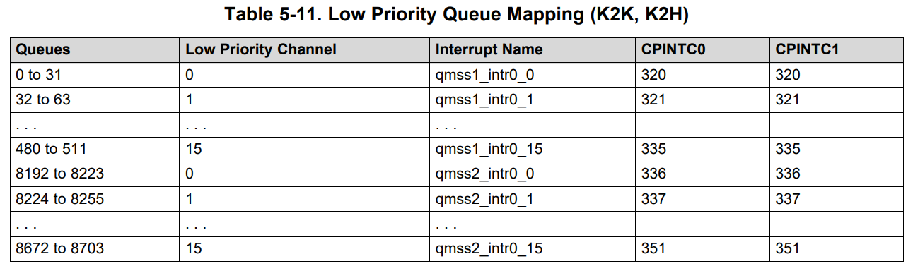

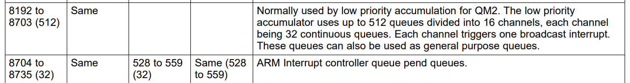

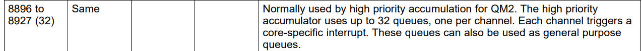

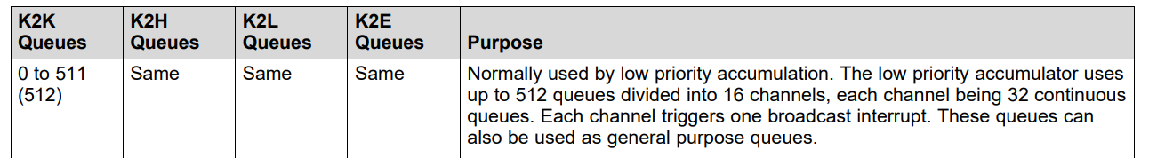

  • Hi Rex,
    I'm a little bit confused, in the Multicore Navigator User's Guide I see these queue allocations:
    Which there is separate interrupts for ARM (8704 to 8735) and actually XGE was using these interrupts for RX queue. On low priority and high priority it says core-specific and later it shows how it maps to DSP cores:
    But as you mentioned the low priority queues 480 to 512 are mapped to interrupt 226 and it is sent to ARM processor. I see this in the DTS file:

  • Hi, Moein,
    In the SoC datasheet, www.ti.com/.../66ak2h12.pdf, Table 8-23 defines ARM interrupts, page 103 for #226.
    In the Queue Maps section (5.1) of the CPPI (or Multicore Navigator) User's Guide, the queues defined in Table 5-2 for Keystone-2 are designated (hard coded) to particular IPs. For example, 8704-8735 are designated to CPSW and defined in netcp.dtsi. You can see both GBE and XGE use them. 8752-8759 are designated to XGE which you can also find corresponding configuration in dtsi file. In the table, none of them are designated to DSP. Therefore, you need to use the gerneral purpose queue.
    The above setup is in kernel space. Using RM and QMSS_LLD, it is in user space. The QMSS_LLD provides the API which hides all these configuration, so user can call qmss_put to transmit and the other side does qmss_get to get the message. The binaries for the examples are included in the tisdk-server-extra-rootfs filesystem tarball. If you want to build them, you may need to run pdkProjectCreate script and setup the build env using the pdksetupenv script. You may find some instructions in RTOS PDK for it. In the RM User's Guide, there are instructions on how to run the examples, processors.wiki.ti.com/.../Processor_SDK_Resource_Manager

  • Hi Rex,
    I see. Table 8-22 has interrupts for core-pac and the only navigator interrupts are the high priority one such as:
    Event 52, QMSS_INTD_2_HIGH_N: Navigator 2 accumulated hi-priority interrupt 0
    My goal is to change the routing from "XGE to ARM" to "XGE to DSP" not to add a redundant latency going through ARM. So I think now the question is how should I setup the high priority interrupt, I'm fine if I need to modify kernel and rebuilt it. I'm actually looking for where this qmss setup steps are performed so I can modify them. Can I do some modifications to the ARM dtsi file to change the setup and only use QMSS_LLD on the DSP side to send/receive data, and if not which kernel modules should I modify on each side?

  • Hi, Moein,
    PktDMA provides a flexible approach but care should be taken to avoid any existing usage of resources. High priority queue can be one of the solutions as long as it is not used by others. General purpose queues can also be an option. There isn't a set rules of what you must use. Setting up the queues on linux side doesn't mean DSP will automatically get it. You will need code to consume the queue. You may want to consider how to manage the interrupt flood on XGE if using interrupt.
    RTOS XGE example only set up SerDes for the BER test. It doesn't set up for receiving and transmitting packets. It also needs to set up queues for transmit/receive. This queue set up also applies to GbE which may be useful as a reference.
