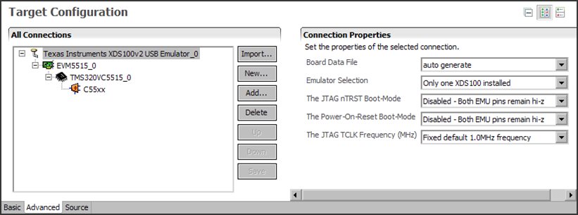

  • Hello Christos,
    I have the luxury of having 4 different XDS100 emulators at my desk. I was able to connect the FDK to each of them (after a little fuss). When creating the target configuration, I selected "EVM5515" as the target and left everything else as default. See screen shot below.
    Many times I saw the error "240/-1063: Bad Silicon Target", but after jiggling the connection, resetting the emulator, and trying again, I was able to connect with each emulator.

    The JTAG adapter that plugs into the FDK seems a little loose. Maybe that was the cause of my "240/-1063: Bad Silicon Target" errors, but in short time I was able to connect reliably.
    Also, when I setup the target configuration for the wrong XDS100 version, I sometimes was not able to connect. Try connecting with both.
    Does your XDS100v2 emulator connect to any other JTAG device? Double check your schematics.
    For your reference, I have copied my tests and a screen shot of my successful target configuration below.

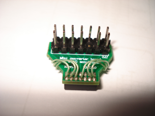

  • Mark,
    I did some investigation since the XDS100 that I have although it is not working with the FDK it does work with the OMAP3530.
    I've focused and checked the FDK Mini Converter Board for the JTAG (1.27mm to 2.54mm). I checked its electrical continuity beteween the 2.54mm connector and the equivalent pins of the 1.27 connector.
    I've found that pins 4, 6, 10, 12 do not conduct between the two connectors although the board gerber shows that they should connect. The pin 6 is the NC, but the 4, 8, 10,12 are the ground pins, from them thus only the 8 does conduct between connectors.
    Could this be the problem, is pin 8 enough for gnd?
    Christos

  • Mark,
    Please, do me a favor, see also in your own
    FDK Mini JTAG Converter,
    if all pins have one-to-one electrical connection from one connector (2.54mm) to another (1.27mm) on the equivalent pins.
    It seems to me that there is no cold solder, but the actual pcb traces for those pins under the 1.27mm connector going between the connector pads, I think they might have a defect, their width looks like half a mil or non existent at all.

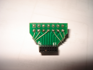

  • Mark,
    Rework on the conversion pcb has done and here are the results

    Now after the remedy on the FDK Mini-Converter Board, it worked on first try, no complain whatsoever.
    The rework was to solder small wires between the two connectors for pins 2,4,8,10,12,14.
    These pins have defect pcb traces (at least on mine) underneath the 1.27mm connector and there is no conductivity or conductivity with resistance (pin 8 ~0.5 Ohm).
    Christos
  • The remedy on FDK Mini-Converter Board
    Christos
  • Christos,
    Nice soldering job!
    I'll bring up this issue with the PCB manufacturer.
