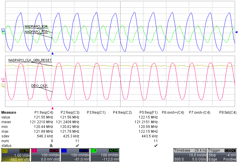

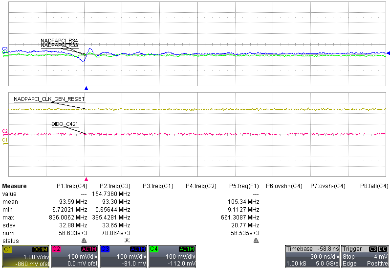

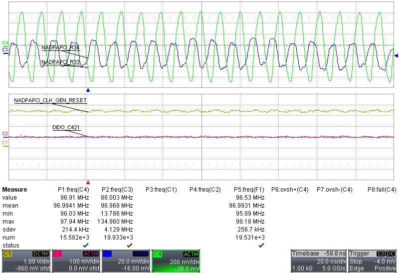

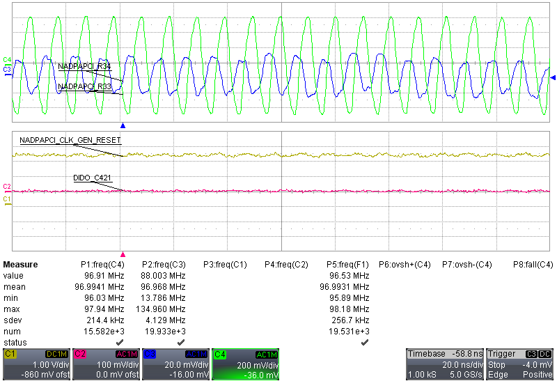

    Check SERDES_CLKP and SERDES CLKN clock pins has stable 100MHz, you can export to CLKOUT0/1 pins and measure with scope
    100MHz clock signal is present with hot and working unit   as in " SERDES check.png"
    With the unit cooled down to 0°C, 100Mhz clock disappears(" SERDES check cold.png").
    The clock is not present until the temperature increases, independently  from boot is  happening correctly or not.
    If block is happening and systems continues booting  (exiting from while), the clock is appearing again.
    But the clock is not exactly 100MHz.
    The board is a plug-in module and if it is run alone, clock workds correctly at 100MH as in "SERDES_check_nomodule.png" (not being terminated , there is some unbalance between + and -).
    I think this is the root cause. You should investigate why on cold temperature SERDES_CLKP/N differential pins do not work properly.

  • Umberto,
    --if CLKOUT is not generated at cold(which is what I understood from customer description), can SERDES clock be generated when PCI is set?
    CLKOUT is not generated, because there are probably no clock signals on the SERDES pins. You should check with the scope on the SERDES pins, AF1 and AF2. If the 100MHz differential clock stops at cold temperature, the problem probably is in the CDCM61002RHB chip, which is stopping to deliver this 100Mhz clock to the DM814x SERDES pins (AF1 and AF2). It is also good (if possible) to measure with scope the CDCM61002RHB chip 100Mhz output pins.
    To sum up, check the 100Mhz signal with scope from both sides (DM814x input and CDCM61002RHB output).
    If the problem is in the CDCM61002RHB chip, then you should ask/post in the below forum:
    External 100MHz SERDES clock is a must for the DM814x PCIe, you can use internal clock only for SATA, but not for PCIe.
