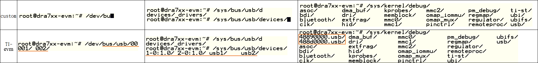

Hi Expert,
I used VisionSDK_V2.9 to get the USB device on TDA2Ex but it failed, System response "unable to initialize libusb: -99".

root@dra7xx-evm:~# lsusb
I guess the problem lies in
[   11.745537] omap-usb2 4a084000.phy: Unbalanced pm_runtime_enable!
[   11.758268] platform 4a084000.phy: Driver omap-usb2 requests probe deferral
Could you please give some suggestion here?
