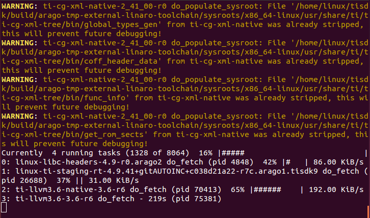

    There are the following mistakes:
    ERROR: OE-core's config sanity checker detected a potential misconfiguration.
    Either fix the cause of this error risk or at your own disable the checker (see sanity.conf)
    Following is the list of potential problems / advisories:
    PATH contains '.', './' or '' (empty element), which will break the build, please remove this.
    Parsed PATH is ['/home/linux/tisdk/sources/oe-core/scripts','/home/linux/tisdk/build/arago-tmp-external-linaro-toolchain/sysroots/x86_64-linux/usr/bin/arm-linux-gnueabi','', '/home/linux/AM5728/linux-devkit/sysroots/x86_64-arago-linux/usr/bin','/home/linux/gccgcc-linaro-6.2.1-2016.11-x86_64_arm-linux-gnueabihf/bin', '']
    I've been wondering where this path is containing  '.', './' or '' (empty element).
  • I do not see it too. Create a new virtual machine and start everything from the beginning.
  • I created a new virtual machine, and according to the detailed procedure you said, the last step of bitbake was the same error:
    Either fix the cause of this error or at your own risk disable the checker (see sanity.conf).
    Have you verified that the detailed step can execute and generate rootfs correctly?

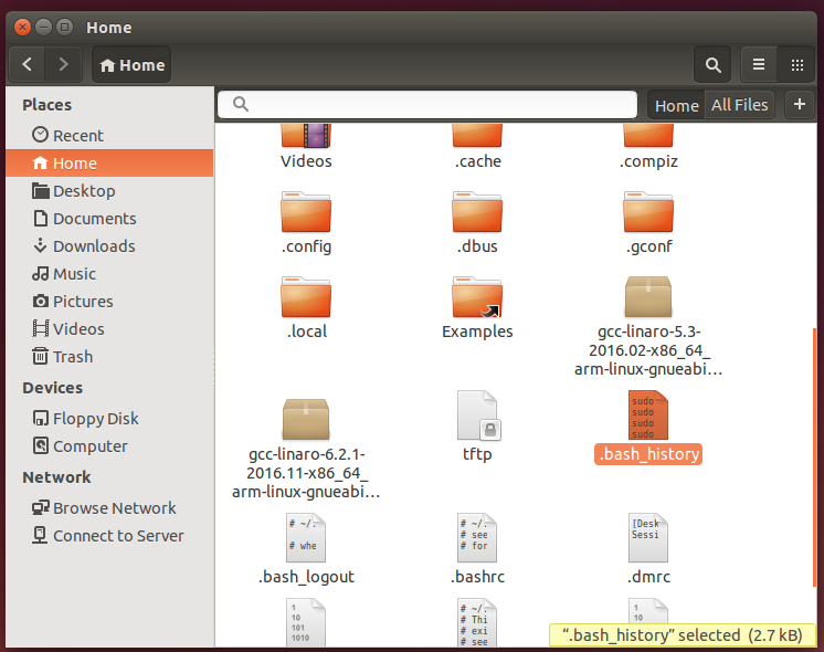

  • We'll see in the future if we have verified that. So now can you close all the terminal windows, open the nautilus (file explorer), go to your home directory and press Ctrl+H then a file named .bash_history will appear, could you attach it plese?
  • The file can't be copied, and I've copied the contents of it, below:

  • So, see your mistakes here:
    export PATH=$PATH:/home/linux/gcc-linaro-6.2.1-2016.11-x86_64_arm-linux-gnueabihf/bin:
    You have entered the half of the command and the other half is missing. The complete command should be:
    export PATH=$HOME/gcc-linaro-6.2.1-2016.11-x86_64_arm-linux-gnueabihf/bin:$PATH
    Also why are you entering this path, do not do that:
    export PATH=$PATH:/home/linux/gcc-linaro-arm-linux-gnueabihf/bin:
    You still trying to build as root, please constrain that, enter exit after the sudo dpkg-reconfigure dash command and build with non root privileges.

    Then, now I completely copy the instructions you gave, after the execution of the new virtual machine, there is no wrong report,
    but I have been downloading things all the time. I have already downloaded more than 14G, and it shows that 16% is finished.
    Is that normal?
  • Yes it is normal, you will download a lot of source and spend plenty of time while building depending on your Internet connection and host configuration. Please, see this post too.
  • Now I execute the instructions MACHINE=am57xx-evm ARAGO_RT_ENABLE=1 bitbake tisdk-rootfs-image,Process to 38%.
