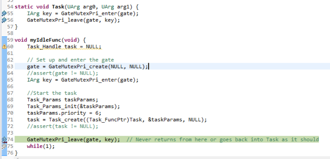

  • Hi Todd,
    The below code causes the crash reliably and instantly.
    static GateMutexPri_Handle gate = NULL;
    static void Task(UArg arg0, UArg arg1) {
    	IArg key = GateMutexPri_enter(gate);
    	GateMutexPri_leave(gate, key);
    void idle_function(void) {
    	Task_Handle task = NULL;
    	// Set up and enter the gate
    	gate = GateMutexPri_create(NULL, NULL);
    	assert(gate != NULL);
    	//Start the task
    	Task_Params taskParams;
    	Task_Params_init(&taskParams);
    	taskParams.priority = 6;
    	task = Task_create((Task_FuncPtr)Task, &taskParams, NULL);
    	assert(task != NULL);
    	GateMutexPri_leave(gate, key);	// Never returns from here or goes back into Task as it should
    	while(1);
    In happens when the GateMutexPri_leave is executed in the idle loop and it never gets back into the task.  Looking in ROV you can see that the GateMutexPri is with the idle loop and its current priority is 6 because the task has requested the gate.  No exception is shown and in the task view ti shows the idle loop has been preempted and has a priority of 6 and that the other task is blocked.  There was another access to the GatMutexPri's in my full code I had missed as you can probably guess it was in the idle loop hence how i discovered this.
    I have tried:
    • Changing the idle loop to a priority 1 task and it worked fine.
    • Just running the idle loop through without starting the task and it worked fine
    • Changing the GateMutexPri to standard GateMutex, again this works fine
    So it seems the issue is when the idle task inherits a higher priority due to the gate request from the task it causes SYS/BIOS to crash.  not sure what else i can do to investigate this, if you could suggest a fix that would be great and for now I will just have to work around it.
    Cheers
    Sean

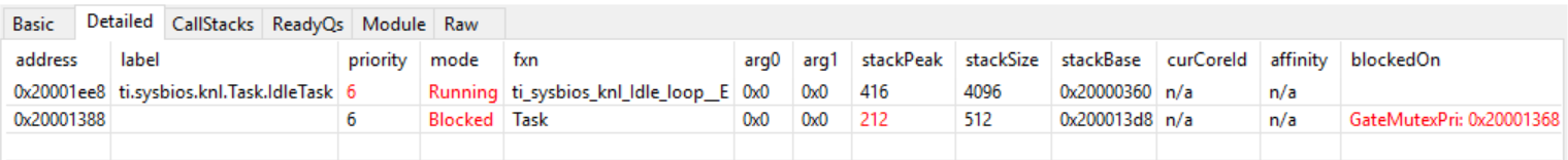

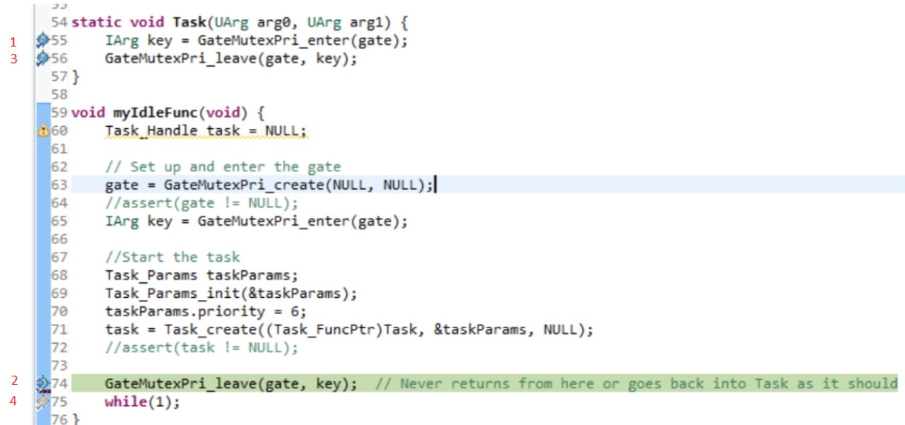

  • Hi Sean,
    While it's strange to have GateMutexPri_enter in an Idle function, I was not able to reproduce your problem. Your example run fine. I had nothing but the myIdleFunc function plugged into Idle (in the .cfg file). I did increase the heap and idle stack size to make sure I had no allocation or stack issues.
    I ran the example and had a breakpoint the the GateMutexPri_leave in the Idle function.
    Note: I had already hit the breakpoint at GateMutexPr_enter in the in the Task function.

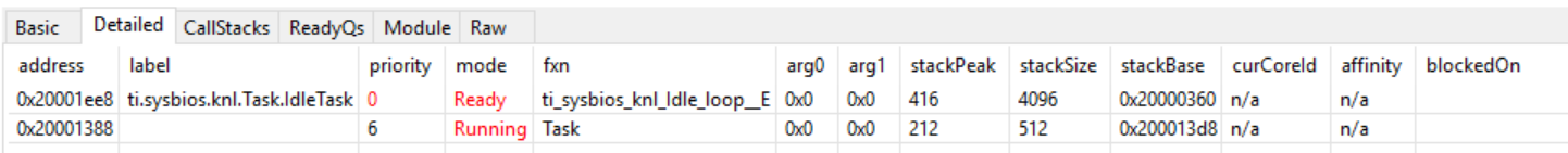

    Here is the Task->Detailed view
    Again weird that Idle is at priority 6, but this should not cause a problem.
    When I ran, I hit the breakpoint at GateMutexPri_leave in the Task function. Again the tasks looked fine.
    I continued and when I halted I see the Task terminated and Idle stuck in the while(1) loop.
    What crash are you seeing with this setup?

    Can you try my exact steps with the same breakpoints that I have above. Do you hit all 4 of them? Then after the last breakpoint, the target should just be running and if you halt, it will be in Idle at the while(1);.
  • Tried that and same issue I also stripped back everything else out of my project to just have that code as before I had some classes etc that would have ran before main and no luck.  Tried changing to c instead of cpp and swapping to the TI compiler and the same behaviour all the time

  • Which one of the breakpoints was not hit?
  • Hi Todd so it gets to the leave in the idle loop and then when you step or run into that you get the exit so it doesn't hit the leave in the task and doesn't get to the while(1).
  • Hi Sean,
    Sorry, I did not quite understand your description. Let's put labels on the break-points.
    You should hit the breakpoints in this order if you are running between breakpoints. Which breakpoint are you not hitting?
    Todd
  • Hi Todd,
    I am not hitting 3 or 4 as it exits inside the leave call at 2 in the idle loop.
    Sean
  • What do you mean by "it exits inside the leave call"? Where does it go? Is there something else running that is taking the processor (e.g. a higher priority task or Hwi) or does it go into the weeds? Does this occur ever time with this simple test case?
