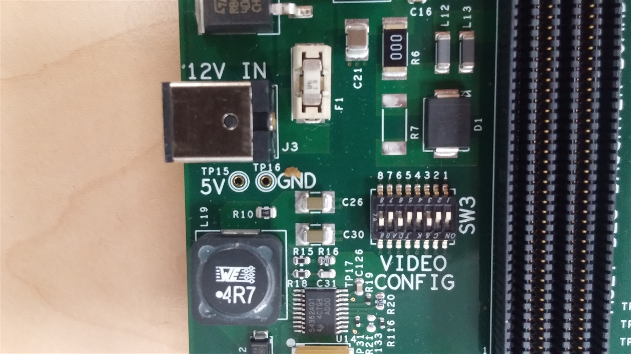

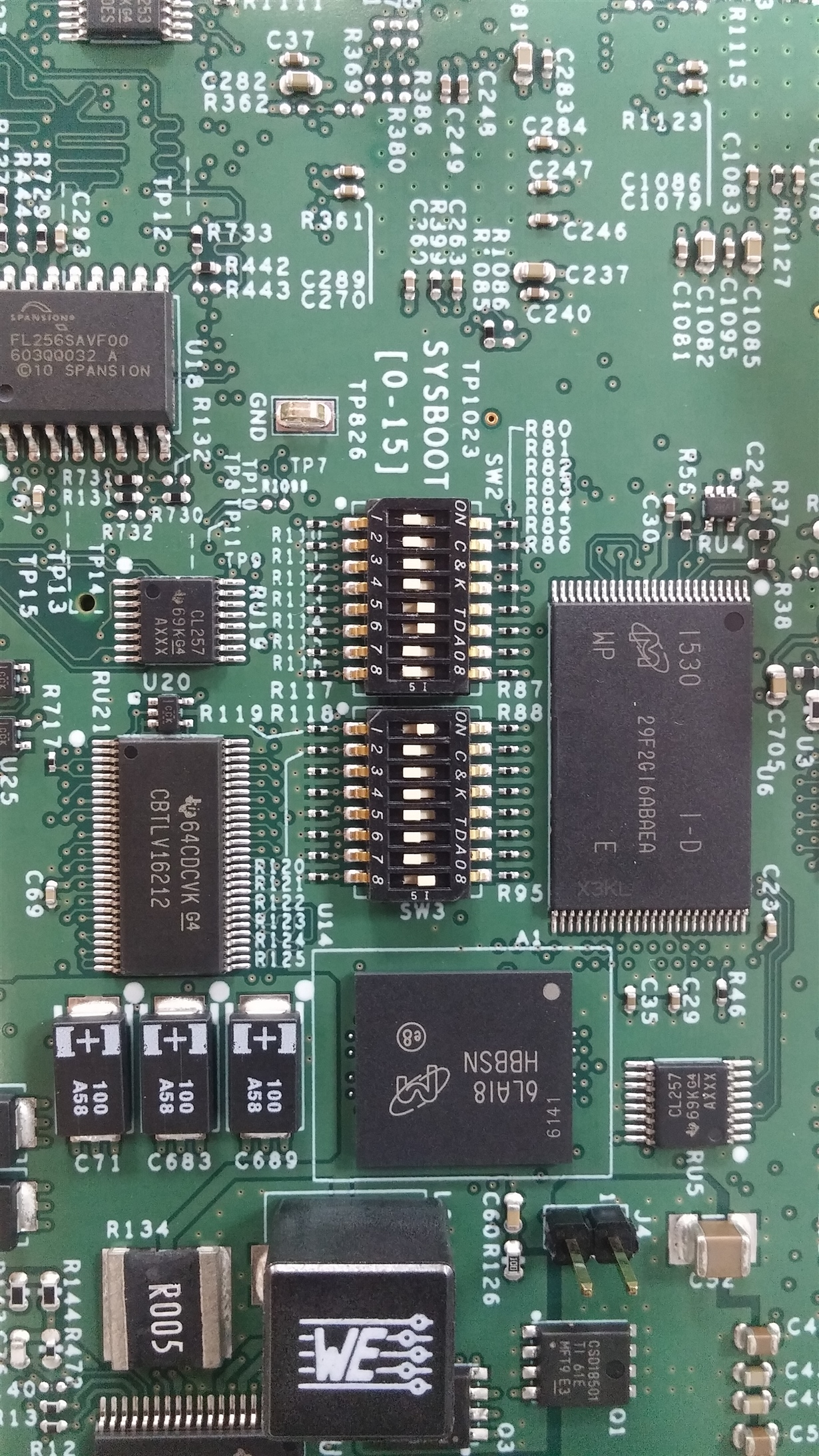

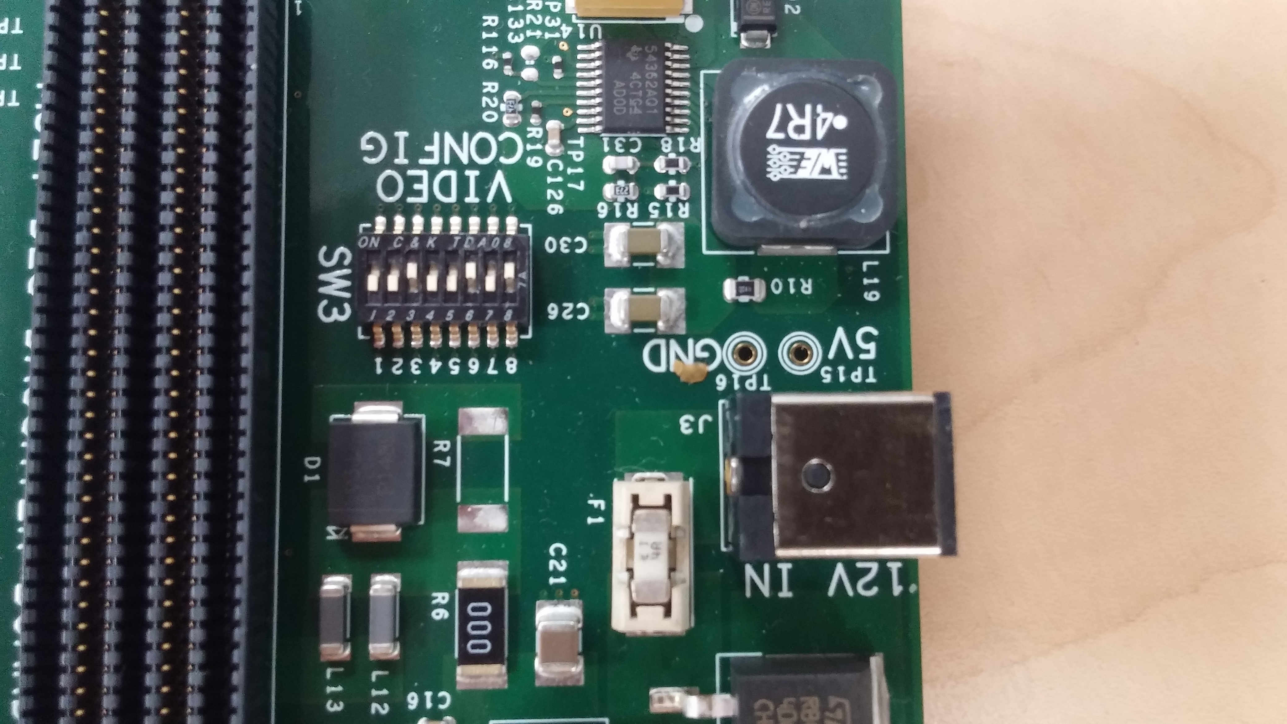

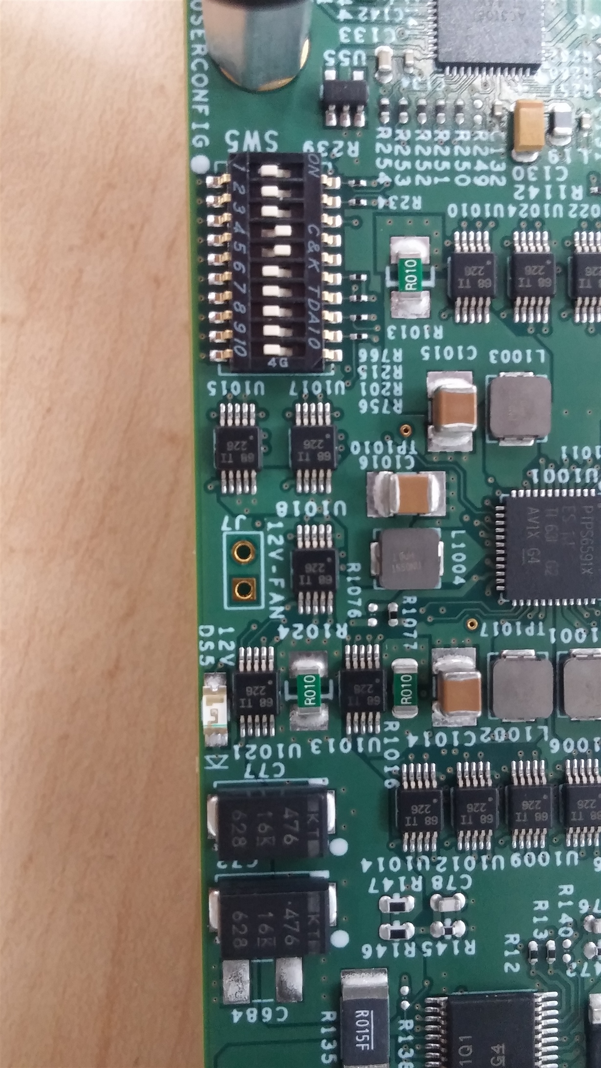

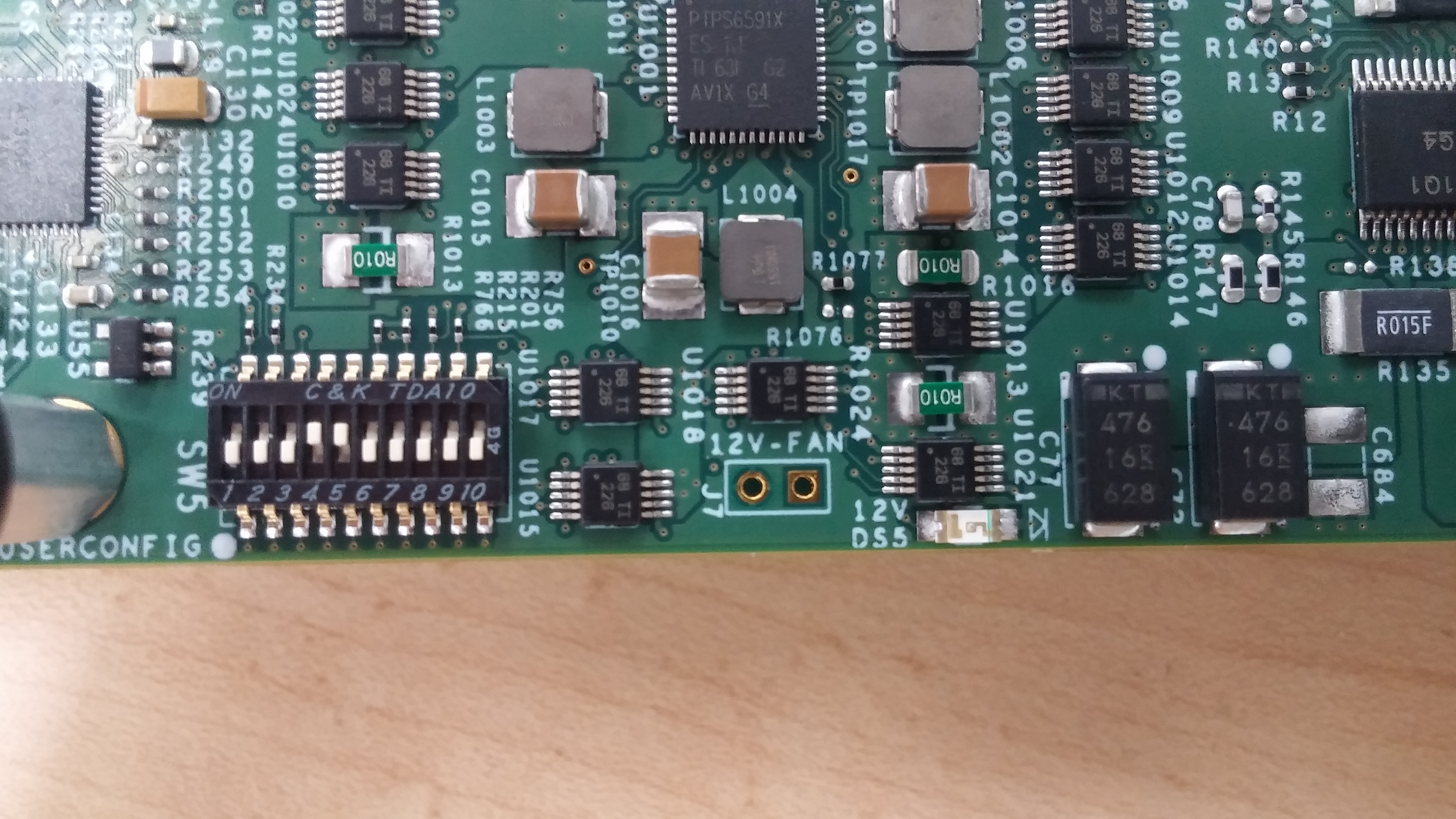

  • Hi Martin,
    Have you tried setting DIP switches to 00100101 (LVDS)?
    Also please check the revision of your TDA2Ex EVM. For Rev A and Rev B, some hardware rework and CPLD reprograming are required for 4 ch LVDS capture thru VIP ports.
  • I have checked the switches are 00100101 and both boards are REV D . Any further thoughts ?
    Thank you

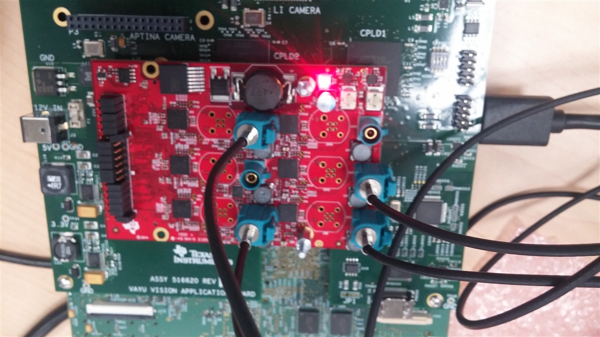

  • Hi Martin,
    From the LOG, the I2C reads of camera modules is failing. Please
    1. Ensure the camera modules are connected to right input ports, refer user guide a pictures show which ports are to be connected to the camera module.
    2. Check if the version of the camera modules are same. Check with the version that works
    Sujith
  • Hi , I swapped each camera into port 1 and they all work with single camera lvds option.
    I tried switches at 00100101 and 00000000 , still hangs.
    Any other things to try?
    thanks
  • Hi Martin,
    Can you please let us know
    1. Version of VisionSDK
    2. Complete Log when you run the multi-channel usecase
    3. Pictures of switches and LVDS setup
    Sujith

    Switch settings are in the attached pictures : boards are REV D
    thank you
  • played around with camera connectors and the lvds demos are now working  if the 4 cameras a plugged into the following ports and the links set as shown ..
