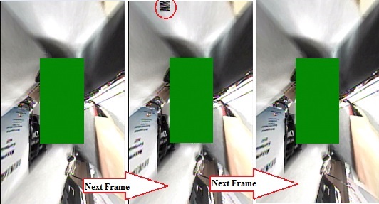

I customized vision_sdk usecase 'lvds_vip_tda3x' to match my cameras(BT656-480i).
However, when I executed it, block noise is partially caused in surround_view image by frame.
And, there are frames where normal frames and noise occur.
And, there is a difference in the size of the noise, but the place where noise occurs is the same.
Please teach the causes of this noise and how to fix it.
Please Note I use the new table data(GAlignLUT,) related to surround_view usecase made by surroundview_tools in vision_sdk.
The vision_sdk version I use is 'vision_sdk_02_12_01_00'.

    I attach the pictures of the block noise.
    And then, I tried some of the surrundview calibration by changing parameters such as output resolution.
    There was also a difference in log at command prompt after running SurroundView.exe of calibration_tool.
    If the log indicate
      Maximu DMA block size (overlapping):
      DMAvermax:256 Dmahormax:384
      Maximu DMA block size (overall):
    the block noise occured on the image.
    If the log indicate
      DMAvermax: less than 256 (for example 96, 128, etc.)
      DMAvermax: less than 384 (for example 336, etc.)
    the block noise did not occured on the image.
    Does this log indication have a relationship to do with block noise?
    Tetsuya

    Is this issue resolved? This corruption seems more like out-of-bound access.
    Regards, Sujith
  • Hi Sujith
    Thank you for the response.
    This issue has not resolved in radically.
    But I was able to prevent block noise from occurring due to adjust the parameters of the tool.
