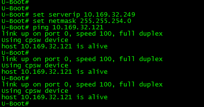

This design can work with the Linux, refer to below screenshot. So there is no problem with the hardware design.

When running on the SK EVM, the link status could be detected if the net cable plug out and in.  And from the PC host side, we can succeed in ping operation with the board.

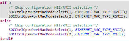

Change the RGMII mode to the RMII mode:

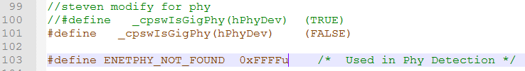

enet_phy.c (located in C:\ti\pdk_am335x_1_0_7\packages\ti\board\src\skAM335x\device)
Change the _cpswIsGigPhy definition from TRUE to FLASE, as this is not the gigabit Ethernet.

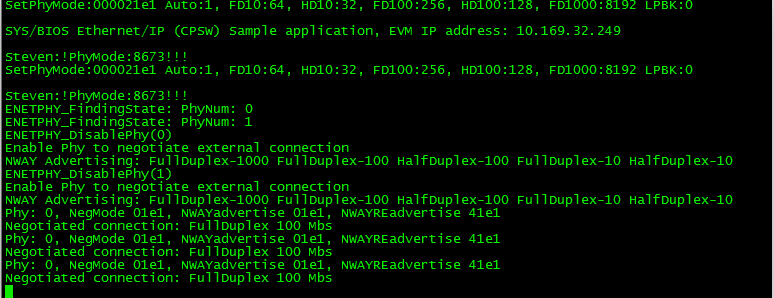

Test result:
In this test, we plug in and out the net cable 3 times, so you could see the connection established 3 times as below:
However, from the PC host side, we cannot succeed in ping operation with the board.

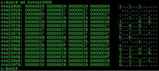

We checked the register for pinmux and gmii_sel settings, it turned out that all the settings took effect.
By comparing with the register dump from the Linux uboot, the pinmux settings for each pins and the gmii_sel registers are all shown the correct values.

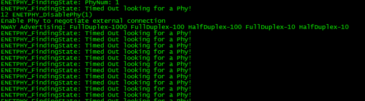

In addition, we also did some test to verify the phy_id settings, if phy_id is changed to other value other than 0 for EMAC1 port, it would report below issue:
So from my perspective, the gmii_sel, pinmux settings, phy_id are all correct.
