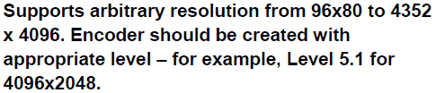

  • hi,
    I find the datasheet as following:
    1.H264_Encoder_HDVICP2_UserGuide.pdf (Literature Number: SPRUHG3 October 2012)
    P.165
    2.and the H264_Encoder_HDVICP2_DataSheet.pdf(SPRS843 – Sep 2012)
    P1
    I am not saying other resolutions are not possible.
    IVA can encode or decode 1080p at 60FPS.
    So if you try to encode 1080p 30fps + 720p 30 fps is possible but 1080p 60fps + 720p 30 is not possible because IVA can not encode at that speed.
