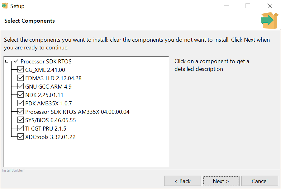

Let me talk about PRU-ICSS-PROFIBUS_Slave 01.00.01.01 and PSDK 4.0.0.4.
I see EDMA_VERSION=2.12.03.27 of projectCreate.bat
C:\ti\PRU-ICSS-Profibus_Slave_01.00.01.01\protocols\profibus_slave\projects\projectCreate.bat
:: Set EDMA3 Version which is to be used while creating the project
set "EDMA_VERSION=2.12.03.27"
but I got EDMA version 2.12.04.28 when I install ProcessorSDK 4.0.0.4.
It is not same EDMA version.
Let me know which version shoud we use ? 2.12.03.27 ? 2.12.04.28 ?
