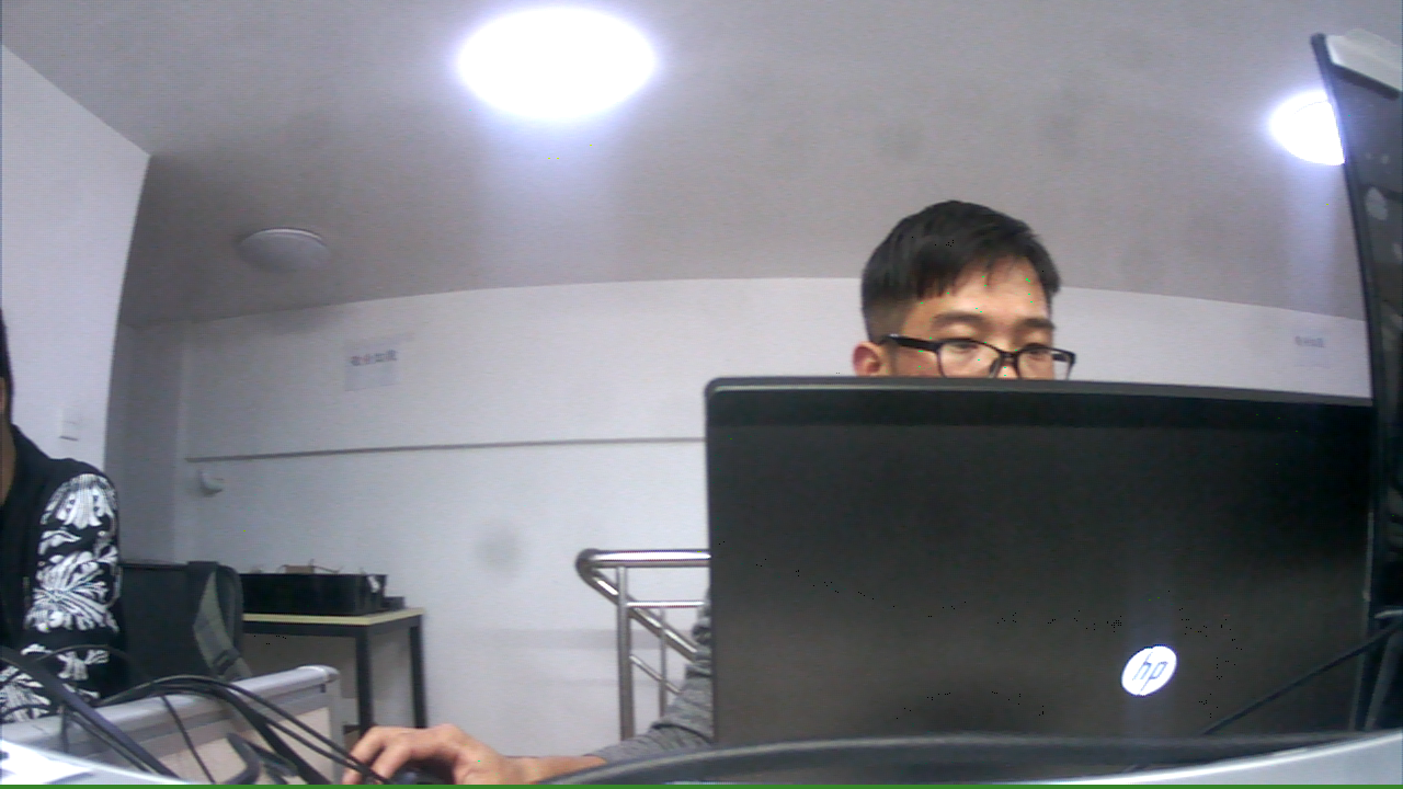

Hi all,
We've made a custom board used for dual video capture(vin3a and vin4a).We use the IOSET4 for vin3a and IOSET3 vin4a,however,the quality of the video is different between that two.Vin3a is ok but vin4a is not so good with the green dot(the picture is attached here ).After doing some test,I found it may be IO timing's problem.I check the  and realized that I should configure the right A_DELAY and G_DELAY value according to the timing mode.I've tried the VIP2_4A_IOSET3_MANUAL1 and VIP2_4A_IOSET3_MANUAL2 but didn't solve my problem.I also tried to move the right iodelay cfg of the vin3a in 7851.mux_data.h,it shows the same question like vin4a.
So,how could i configure the right value of A_DELAY and G_DELAY?Is there anything change i should make according to our own designed board.
