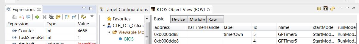

    Attached is the test project with pre-built out file. I saw both Timer interrupt counter (timer id 5, GP timer 6) increased and TaskSleep() returns (timer id 4, GP Timer 5).
    Regards, Eric

    Meanwhile I experimented with different settings and debug strategies.
    Suddenly I realised that it works, but first could not figure out what I did differently.
    After some more tests I found out that:
    Setup 1) it does "not* work when I debug like this:
    - complete power down / power up of the IDK
    - launch target configuration
    - connect to A15 -> gel files are executed (to get the C66 out of reset)
    - connect to C66
    - load the program
    - program halts at main and does not work ("counter" remains at 0, Task_Sleep returns)
    Setup2) it does work when I do this:
    - choose menu "Run / Debug as / Code Composer Studio Debug Session"
    - program halts at main and it works ("counter" counts up, Task_Sleep returns)
    Can you give me a hint what is done differently on Setup 2 ?
    Markus
