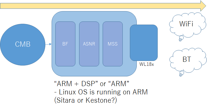

My customer is requesting the demonstration/reference design of Voice pre-processing and network connection on Linux OS.
Of course, I know TI's reference designs for Voice pre-processing. (TIDEP-0077,0088......)
But these designs is just using DSP only and OS is RTOS. It is not connect to network.
Also, I know "Voice Triggering and Processing With Cloud Connection to IBM Watson® Reference Design"(TIDEP-0083)
But they want 1 chip solution and Bluetooth is required.
Do you have such a demonstration or reference design?
It is OK, ARM + DSP or ARM only.
I know it is possible if they create, but my customer want to see and run it soon.
Please advice if possible.

  • Hi Taka-san
    We have an application note that talks about how to hook up a C5517 to AM335x , pointing you to that in case you were not aware
    Sitara Linux ALSA DSP Microphone Array Voice Recognition
    www.ti.com/.../sprac97
    I will ask the authors to provide more guidance on potential single chip solutions, but I do not think we have something up and running in Linux with a unified ARM+DSP processor (K2G does have this as you pointed out - but based on TI RTOS).
    Does your customer have any price target in mind?
    Does the C5517+AM335x solution work?
    Mukul
  • Hi Taka-san,
    We have not done much work with ARM-only solutions using a multiple microphone array, but as you have discovered, we have several applications using a DSP for microphone processing.
    Amazon does have a C++ based SDK that includes a sample application a wake word engine from Sensory (triggered by saying "Alexa").  This demo application runs very nicely on the BeagleBone Black and BeagleBone Black Wireless (AM335x running the community-supported Debian operating system + TI Linux kernel).
    More information about the Amazon SDK can be found here: https://developer.amazon.com/alexa-voice-service/sdk.  The source code on github is here: https://github.com/alexa/avs-device-sdk.  The instructions for the Raspberry Pi will largely apply to the BeagleBone, with a few minor differences.  You can find more information on my blog (not affiliated with TI): http://www.erdahl.io/2017/11/alexa-voice-service-on-beaglebone-black.html
    Mike

    Currently, they hope to run the voice pre-processing and network/usb on single device(ARM+DSP).
    The following configurations are the best for them.
     - ARM: network/usb on Linux
     - DSP: voice pre-processing on RTOS
     - ARM<=>DSP: SYSLINK, IPC.....
    My customer believe that this configurations can utilize strong points of TI ARM+DSP device.
    If you can do such a demo, please let me know. (I will try to consider this at my end.)
