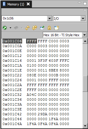

    In essence, I see that none of the peripheral registers (the ones mapped into the IO space) when viewed from the "VIEW REGISTER" window agrees with the data presented by viewing the Memory screen when the IO tab is selected.
    I also notice that single stepping through code that I know is modifying peripheral registers does NOT get updated after the single step (even after I manualy refresh the window contents using the update button).

    For some reason, the View --> Registers window is reading from PROGRAM memory instead of IO memory.
    Here is the workaround, until this is resolved in CCSv4:
    Open Memory Viewer: Click on View --> Memory, Enter address 0x1C06 (start of GPIO registers), Select 'I/O' from drop down menu. Select 'Hex 16 Bit - TI Style Hex' from drop down menu. View and Modify registers at will.
    Refer to Chapter 3 - Registers of the GPIO User's Guide for register to I/O memory address mapping and register bit definitions.

  • That has been my work around to date.  The issue was brought up in the CCS forum here: http://e2e.ti.com/support/development_tools/code_composer_studio/f/81/p/69682/323421.aspx#323421.
    Basically, the xml files which define the 5505 register layout are missing a memory space specifier.  By adding the page="?", where ? is 0 for program, 1 for data, or 2 for IO to the register xml, the registers read correctly in CCS.
