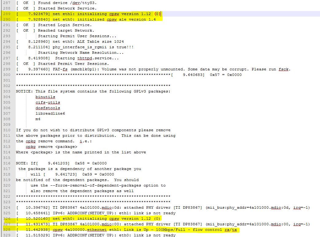

    It seemed there is no issue and links were detected well and each ethernet ports get ip address successfully from different DHCP server during 1 ~ 8.(under '/Normal' directory).
    e.g. it seemed there was no issue while booting and all ethernet ports are working well before trying to make 'eth1' down by using ifconfig.
    From 9(9th log), you can find 'kernel log:cpsw 4a100000.ethernet eth0: Link is Down’ message although only eth1 was down.
    10 ~ 16 logs, all logs are after 'Link-Down' occurred.

    In below 290th line captured from Booting-log.txt, what is the meaning of 'net eth0: initialized cpsw ale version 1.4'? is this related with this issue?
    Do you still think there was an issue in Link connection?

    [    1.081987] davinci_mdio 4a101000.mdio: davinci mdio revision 1.6
    [    1.088126] libphy: 4a101000.mdio: probed
    [    1.093605] davinci_mdio 4a101000.mdio: phy[0]: device 4a101000.mdio:00, driver TI DP83867
    [    1.102006] davinci_mdio 4a101000.mdio: phy[13]: device 4a101000.mdio:0d, driver TI DP83867
    [    1.111048] cpsw 4a100000.ethernet: Detected MACID = 98:5d:ad:48:b5:d1
    [    1.117814] cpsw 4a100000.ethernet: cpts: overflow check period 500 (jiffies)
    [    1.126133] cpsw 4a100000.ethernet: cpsw: Detected MACID = 98:5d:ad:48:b5:d3

    [    8.355177] net eth1: initializing cpsw version 1.12 (0)
    [    8.422161] net eth0: initialized cpsw ale version 1.4
    [    8.427341] net eth0: ALE Table size 1024
    [  OK  ] Started Login Service.
    [  OK  ] Reached target Network.
             Starting Network Name Resolution...
             Starting Permit User Sessions...
             Starting thttpd.service...
    [    8.885359] TI DP83867 4a101000.mdio:0d: attached PHY driver [TI DP83867] (mii_bus:phy_addr=4a101000.mdio:0d, irq=-1)
    [  OK  ] Started Permit User Sessions.
    [    9.276145] IPv6: ADDRCONF(NETDEV_UP): eth1: link is not ready
    [    9.456355] FAT-fs (mmcblk0p1): Volume was not properly unmounted. Some data may be corrupt. Please run fsck.
    [    9.546288] net eth0: initializing cpsw version 1.12 (0)
    [  OK  ] Started Network Name Resolution.
    [  OK  ] Started thttpd.service.
    [    9.721888] TI DP83867 4a101000.mdio:00: attached PHY driver [TI DP83867] (mii_bus:phy_addr=4a101000.mdio:00, irq=-1)
    [    9.927389] IPv6: ADDRCONF(NETDEV_UP): eth0: link is not ready

    [   12.003247] cpsw 4a100000.ethernet eth0: Link is Up - 100Mbps/Full - flow control rx/tx
    [   12.011349] IPv6: ADDRCONF(NETDEV_CHANGE): eth0: link becomes ready

  • Hi Schuyler,
    Thanks for your immediate response.
    I attached log when cable was disconnected in eth1, and they removed cable from the 'eth1' after 'ifconfig -a' printed.
    You can find ‘[   48.483182] cpsw 4a100000.ethernet eth1: Link is Down’  msg describing cable disconnection at eth1 in the 421th line.

    [    8.251605] net eth1: initializing cpsw version 1.12 (0)
    [    8.329795] net eth0: initialized cpsw ale version 1.4
    [    8.461269] net eth0: ALE Table size 1024
    [    8.749487] TI DP83867 4a101000.mdio:0d: attached PHY driver [TI DP83867] (mii_bus:phy_addr=4a101000.mdio:0d, irq=-1)
    [    9.101756] IPv6: ADDRCONF(NETDEV_UP): eth1: link is not ready
    [    9.323061] net eth0: initializing cpsw version 1.12 (0)
    [    9.620578] TI DP83867 4a101000.mdio:00: attached PHY driver [TI DP83867] (mii_bus:phy_addr=4a101000.mdio:00, irq=-1)
    [  OK  ] Started Serial Getty on ttyS0.
    [  OK  ] Started Serial Getty on ttyS3.
    [  OK  ] Started Getty on tty1.
    [    9.873150] FAT-fs (mmcblk0p1): Volume was not properly unmounted. Some data may be corrupt. Please run fsck.
    [    9.937386] IPv6: ADDRCONF(NETDEV_UP): eth0: link is not ready
    [  OK  ] Reached target Login Prompts.
             Starting Synchronize System and HW clocks...
    [  OK  ] Started Synchronize System and HW clocks.
    [  OK  ] Listening on Load/Save RF Kill Switch Status /dev/rfkill Watch.
             Starting rng-tools.service...
    [   11.043055] cpsw 4a100000.ethernet eth1: Link is Up - 100Mbps/Full - flow control rx/tx
    [   11.051159] IPv6: ADDRCONF(NETDEV_CHANGE): eth1: link becomes ready
    [  OK  ] Started rng-tools.service.
    [   11.294632] random: crng init done
             Starting thermal-zone-init.service...
    [  OK  ] Started thermal-zone-init.service.
             Starting Hostname Service...
    [  OK  ] Started Hostname Service.
    [   11.923084] cpsw 4a100000.ethernet eth0: Link is Up - 100Mbps/Full - flow control rx/tx
    [   11.931188] IPv6: ADDRCONF(NETDEV_CHANGE): eth0: link becomes ready

    [    1.004451] libphy: Fixed MDIO Bus: probed
    [    1.081952] davinci_mdio 4a101000.mdio: davinci mdio revision 1.6
    [    1.088091] davinci_mdio 4a101000.mdio: detected phy mask ffffdffe
    [    1.095698] libphy: 4a101000.mdio: probed
    [    1.099740] davinci_mdio 4a101000.mdio: phy[0]: device 4a101000.mdio:00, driver TI DP83867
    [    1.108129] davinci_mdio 4a101000.mdio: phy[13]: device 4a101000.mdio:0d, driver TI DP83867
    [    1.117213] cpsw 4a100000.ethernet: Detected MACID = 98:5d:ad:48:a0:f2
    [    1.124074] cpsw 4a100000.ethernet: cpts: overflow check period 500 (jiffies)
    [    1.132385] cpsw 4a100000.ethernet: cpsw: Detected MACID = 98:5d:ad:48:a0:f4
    BTW, Could you please check their modification in their DP83867 driver file? dp83867.zip
    And, more observations for this issue are as below.
    * when eth1 down using ethtools, eth0 was also down. this is a problem, as you understand.
      at this issue occurred, they found power consumption also reduced in eth0, and almost registers set to 0x1140.
    * when eth1 down, they found there are so many packet transfers observed through oscilloscope, and it seemed all registers were scanned by increasing register address.
    Thanks and Best Regards,
    SI.
