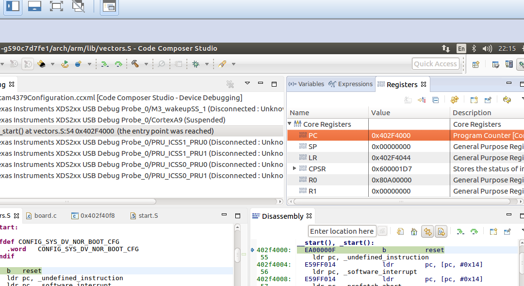

My AM4379 customer board  no information is exported from the serial port  when run pre-built TI-SDK kernle image. My TI- SDK version is I the latest version.

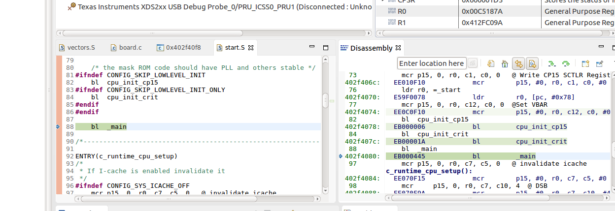

So I debugged the SPL with the emulator. Load u-boot-spl.bi to Address 0x402F4000. Is this  load address right? The following diagram:

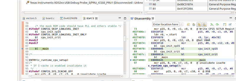

I found that SPL was hung up after  "bl main" was finished.The following diagram is the process of the program execution and the hanging location.
My AM4379 customer board no EMMC device and eprom is used,DDR3 RAM and NAND FLASH is 512M. Besides this, the circuit and the TI-AM4379-EVM are almost the same.
However, in my understanding, the SPL runtime is just a very simple configuration for CPU, and the program runs in RAM, so there is little difference from the peripherals. So I wonder why our board boot SPL won't succeed. Please give me some advice from the expert. Thank you very much.

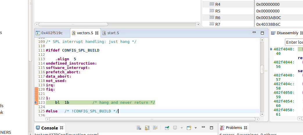

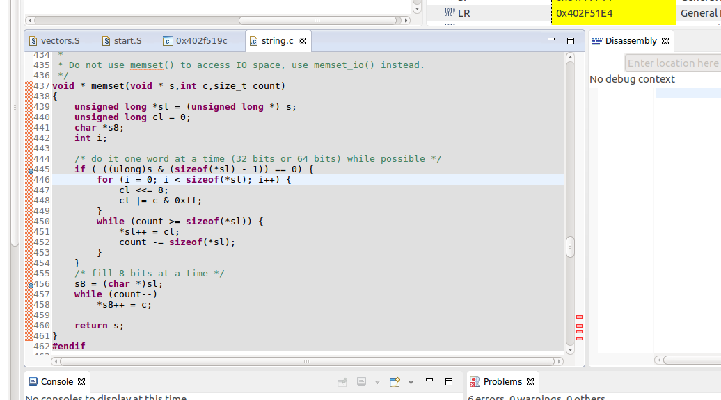

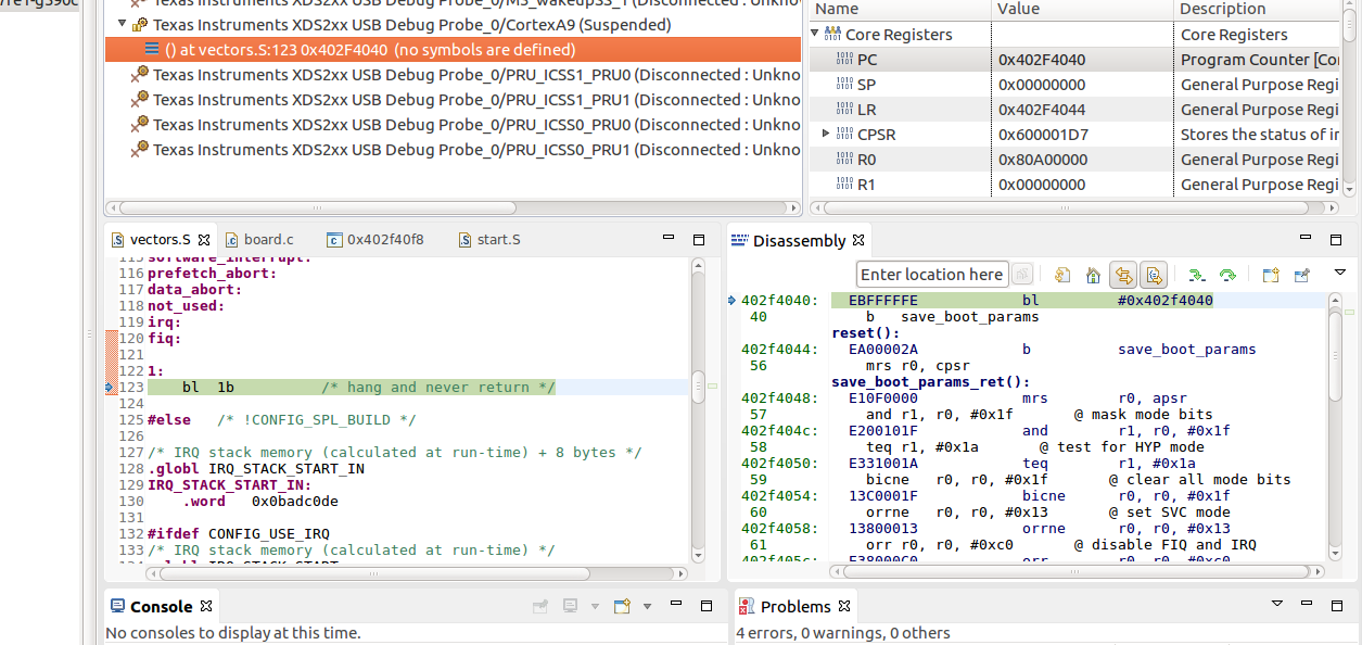

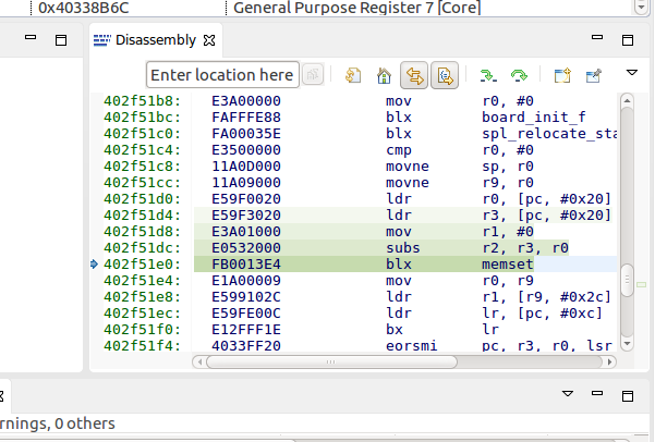

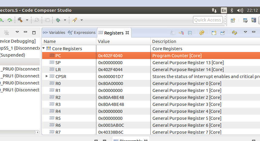

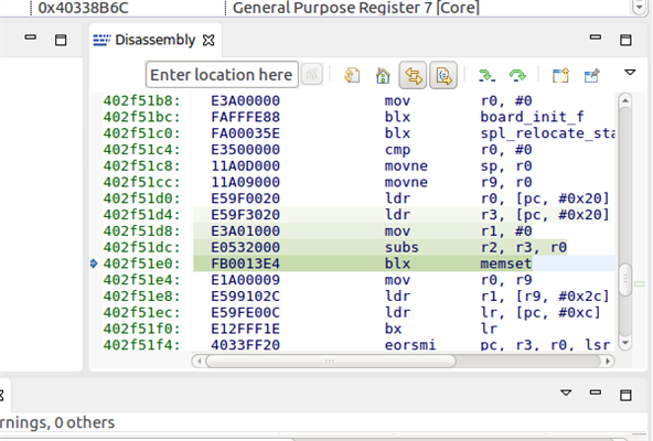

    I have not an on-board ID EEPROM.  But it seems that the problem is not EEPROM. Because I found through single step debugging, SPL boot had been skipped to SPL interrupt and hang before it went to EEPROM
    check.  After completion low_init, Jump in main(bl main). Execution in _main, An exception occurs when the execution is to memset. In a single step in memset, the program won't be hang, but the use of continuous
    running will immediately jump to the SPL interrupt . I can't be sure whether it is my emulator problem or my CCS 7.3 debug setting is incorrect. Or because the previous SPL BOOT low init made the wrong setting. But it
    seems that the previous settings are all the same, and have not been customized.
    In addition, my "load memory" spl.bin address is 0x402f4000, is this the correct load address? If not, will it have an impact on debugging? What is the correct load address?
    My emulator model is XDS200.

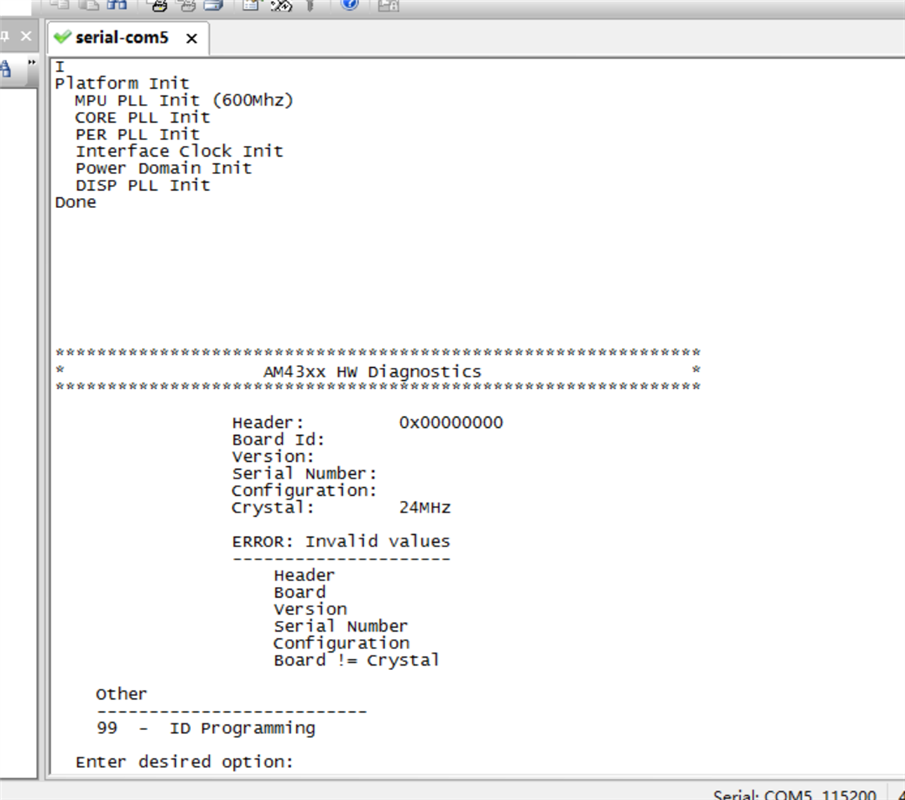

    I used the diagnostic MLO you provided. The following diagnosis results were obtained.
    My board is a customer board,no EEPROM,So it can't be detected version,serial number.
    What I want to ask is “Board != Crystal”,Does it mean that The crystal I use does not match the TI development board,So I'm going to modify the CLOCK configuration in the SPL startup settings?
    The boot exception is due to the fact that the CLOCK configuration does not match the actual crystal? Thank you!

    The diagnostic MLO is for AM437x EVM, where OSC0 24MHz is used.
    What is the frequency you are using on OSC0 (19.2MHz, 24MHz, 25MHz and 26MHz are the supported options)? This is the clock crystal attached to OSC0_IN/XTALIN/C25 and OSC0_OUT/XTALOUT/B25 pins.
    If you are using different than 24MHz on your custom board, you should apply this in sysboot[15:14] pins and CTRL_STS[23:22] SYSBOOT15_14 bit-filed. See AM437x TRM, section 5.2.4.3 Clocking Configuration
