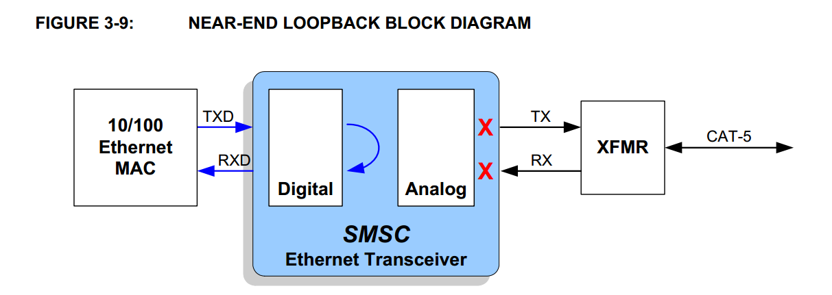

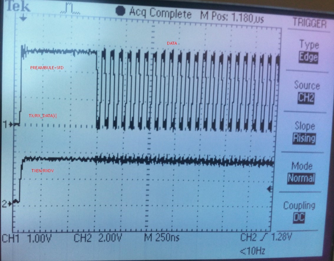

Using the oscilloscope I can see the MII correctly signals on the mii_rxd[0-3], mii_txd[0-3], mii_rx_clk, mii_tx_clk, mii_tx_en, mii_rx_dv pins. I do not understand how I must connect the mii_rx_link (I do not connect it now). mii_rx_er signal is always “0”. mii_rx_col signal using only at the RMII mode.
When I read the __R31 register I always get 0x1000000 (1<<24 - at the GPI_MII mode it must be CRC error, spruh73p, Table4_32).  Another strange situation become when I write the following code:

    >>As you have seen the signals on the mii_rxd[0-3], it appears these pins are not multiplexed properly.
    Why? It was external signals which I tried to read. I tried several ways (with the same result):
    1.send packs from PC to the BBB using PHY (Lan8710, Microchip). This way was probable because I was using the prototyping board and get a lot of noise instead of real signal.
    2. connect rx<->tx inside PHY chip (loop mode) so tx signal was copping to the rx. The noise was more lower and the signals seemed good.
    3. connect rx<->tx (tx_data[i] > rx_data[i]; tx_en > rx_dv; clock (25MHz from clocout2 output) to the rx_clk and tx_clk, tried to connect tx_en > crs and tx_en > rx_er(I want to see error status at the R31 reg) on the prototyping board (look the photo). The signal was really good with low noise.
    Every time I can see that the rx_dv signal was changed from LOW level to HIGH level, which means (as I understand) that MII_RT module receive the pack. (also PRS0_pr1_mii0_crs status bit indicates "1" during this time).

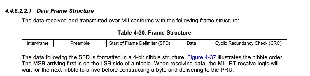

    I have the idea, that error can be at the this area:
    May be when I connetc tx to rx, MII_RT module get wrong structure of the pack and can not parse it? Is it possible? Or not?
  • Alex,
    Your analysis makes sense. So have you tried to update the Tx code below to include 7 octet 0x55 preamble and one octet SFD 0xD5? What does the RXERR0/1 register look like?

            volatile int h = 0x80;
            volatile int i;
            __R30 = 0xFFFF0000|0x5555;//preambule 1,2 octets
            __R31 = (1<<25);//push to the mii tx
            __R30 = 0xFFFF0000|0x5555;//preambule 3,4 octets
            __R30 = 0xFFFF0000|0x5555;//preambule 5,6 octets
            __R30 = 0xFFFF0000|0x55d5;//preambule 7 octet + SFD
            for (i=0; i<40; i++)
                __R30 = 0xFFFF0000|0xABAB;//pack data
            __R30 = 0xFFFF0001;//pack data
            __R31 = (1<<25)|(1<<29);//push to the mii tx
