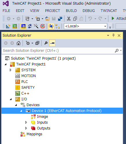

I have a question about TwinCAT 3.1. When I created a TwinCAT project and scanned on Devices, Device 1 (EtherCAT Automation Protocol) was detected. After that, even though I scanned on Device 1 (EtherCAT AP), TI Box (ti-esc) was not detected. The latest TwinCAT 3.1 uses VS 2013, can I think of this as the cause of the problem?
I used TwinCAT 3 before, so I think some operations I did are correct. I've copied TiEtherCATLib.xml to the specified directory. NIC is "Installed and ready to use device".

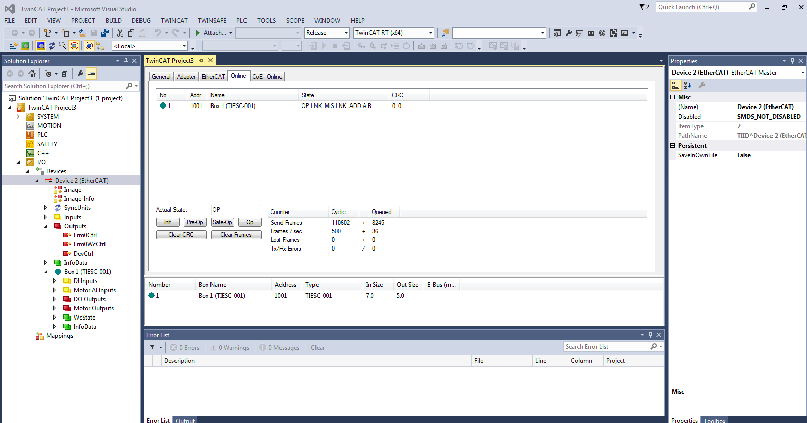

    I apologize for the delay. In addition to the steps you mentioned I also generated a 7 day license.
    I was able to fully enumerate the Full EtherCAT  slave configuration.

    2.Copy [INSTALL-DIR]/examples/ethercat_slave/esi/TiEtherCATLib.xml to <Drive>:\TwinCAT\3.1\Config\Io\EtherCAT folder
    Scanning on "Devcie 1 (EtherCAT Automation Protocol)" is not nothing happened. Please let me know if you have any ideas.

    The version of TwinCAT that I am using is TC31-Full-Setup.3.1.4022.4.   I copied TiEtherCATLib.xml from C:\ti\PRU-ICSS-EtherCAT_Slave_01.00.04.02\examples\ethercat_slave\esi to C:\TwinCAT\3.1\Config\Io\EtherCAT
    The Ethercat project that I used is EtherCAT 1.00.04  ethercat_slave_full_Am335x_arm . This was created by (at a high level)
    If we need to use ethercat_slave_demo_Am335x  that is ok too. We just need coordinate on the example selection.
    The project was build in AM335x_release without a linker command file. The RTSC tools were XDCtools version 3.32.1.22_core, SYSBIOS 6.46.5.55, and am335xPDK 1.07. It was compiled using CCS 7.1.0 and gcc-arm-none-eabi-4_9-2015q3
    When run Twincat shows the following

  • Hi Kazu
    Our logs match. I was able to run the Demo build without problem using the TwinCAT from TC31-Full-Setup.3.1.4022.4.
    The TwinCAT2 documentation included a list of Network devices
    infosys.beckhoff.com/english.php
    We have found that it is best to run TwinCATand CCS on separate computers to avoid processor loading issues. When both are simultaneously run on the same computer, it is possible to encounter periodic EtherCAT timeouts.
    David
  • Hi David,
    Thank you anyway. I'll use another PC and reconfirm my procedure for TwinCAT3.
    Kazu
