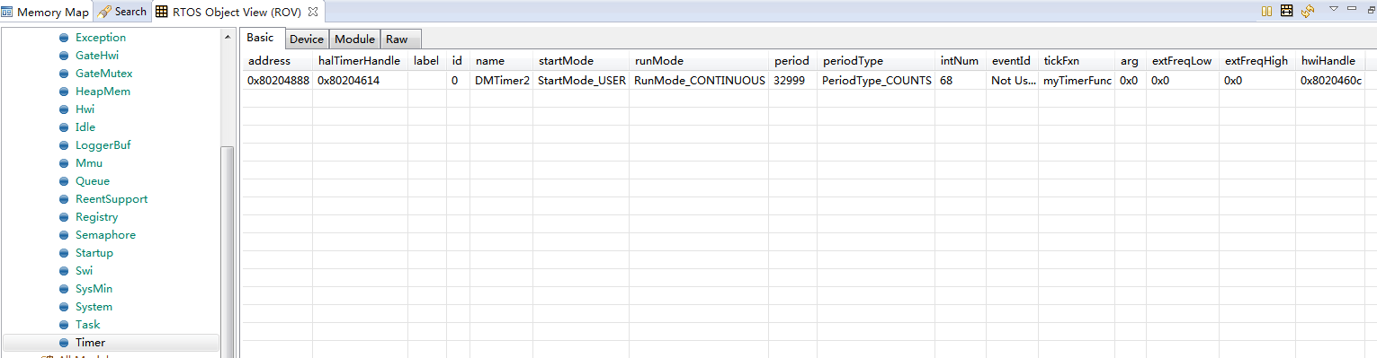

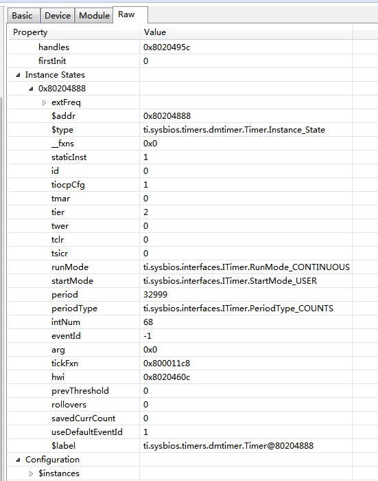

  • Can you open Tools->ROV and see what the state of the system is? For example, is the Timer created properly.
    Todd
  • The timer state:
