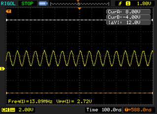

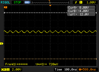

My key customer report an AM3352 LCD controller data[4](AM3352BZCZ Pin T1) functionality issue in RGB565 mode in several failure board, this Pin is always output "1" and can not be set during AM3352 running in application, and customer has done the ABA test, the follows picture can describe the issue more detailed:
Failure chip waveform: data[4](T1) always keep high:
Good chip waveform: data[4](T1) :
CQE engineer has done the ATE test on failure chip and reballed it , could you please help verify it on EVM, thansk so much!
