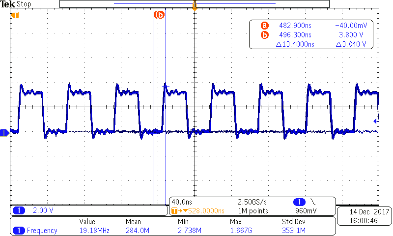

Hi  Expert:
We find that visionsdk 2.12.02 the Linux operate QSPI speed setting at ~19Mhz.
At uboot we setting QSPI speed is 76.8MHz. (arch/arm/dts/dra71-evm.dts), probe the QSPI clock signal the speed is 76.8MHz.
But when kernel start, probe QSPI clock first it is 76.8MHz, when enter Linux console the QSPI read/write speed just 19MHz.
Default mode read 0x4b000040 it is 0x80000004.
use omapconf write 0x4b300040 0x80000001 change QSPI clock div from 4 to 1. the QSPI speed change to 76.8MHz at kernel.
Could you please help us check which part to code change the QSPI speed at kernel?
At DTS file we setting QSPI max speed is 76.8MHz, but we did not which part of code change the QSPI clock setting.
Best Regards!
Han Tao

  •  Hi RK:
    Yes, the dts file setting QSPI interface and QSPI flash speed are 76.8MHz.
    You can try run vision SDK 2.12.02 prebuild image. (tda2xx-evm/tisdk-rootfs-image-dra7xx-evm.tar.xz )
    Test EVM board U18 pin 16, the clock is 19MHz.
    If you use processor sdk 3.02 ()
    file system. test U18 pin 16, the clock is 76.8MHz.
    Believe Vision SDK has changed QSPI interface setting.
    Test command root@dra7xx-evm:~# dd if=/dev/mtd6 of=/dev/null
    Best Regards!
    Han Tao

  • Hi Ravi:
    Please check below print out log.
    0x4b300040 setting is 0x8000000.
    We find that vision sdk change 0x4a009838 register.
    omapconf read 0x4a009838  the value is 0x05030002.
    If we change 0x4a009839 to 0x01030002, the QSPI read speed change to 76.8MHz.
    best regards!
    Meng xiang jian

  • Hi Meng Xiang Jian
    Ok, after setting CM_L4PER2_QSPI_CLKCTRL.CLKSEL_DEV to right value (divide by 1), you are able to get 76.8Mhz.
    Ravi
  • Hi Ravi:
    Yes.  Change CM_L4PER2_QSPI_CLKCTRL.CLKSEL_DEV can use 76.8Mhz read QSPI.
    But we did not know whether code modified those register.
    Just find dts have descript about those register.  Uboot those register is divide by 1, but kernel it divide by 4.
    Best Regards!
    Han Tao
  • Han Tao
    1. The U-BOOT or kernel is NOT configuring the CM_L4PER2_QSPI_CLKCTRL.CLKSEL_DEV bits.
    2. The default value is 0, it means to provide maximum clock frequency, internally the qspi driver QSPI_CLOCK_CNTL_REG used to divide the clock based on desired value.
    1. Reference in kernel for this register is clock dtsi file @ arch/arm/boot/dts/dra7xx-clocks.dtsi.
            qspi_gfclk_div: qspi_gfclk_div {
                    #clock-cells = <0>;
                    compatible = "ti,divider-clock";
                    clocks = <&qspi_gfclk_mux>;
                    ti,bit-shift = <25>;
                    ti,max-div = <4>;
                    reg = <0x1838>;
                    ti,index-power-of-two;
    1. In u-boot:  CLOCK_SOURCE is selected as 1 (PER_QSPI_CLK from DPLL_PER)
    arch/arm/cpu/armv7/omap5/hw_data.c
    void enable_basic_clocks(void)
    #ifdef CONFIG_TI_QSPI
            setbits_le32((*prcm)->cm_l4per_qspi_clkctrl, (1<<24));
    #endif
    I assume in your SPL code, some where the bit 26:25 of CM_L4PER2_QSPI_CLKCTRL.CLKSEL_DEV has been set to 4.
    Ravi
  • Hi Ravi:
    It is vision SDK IPU firmware change QSPI speed to 19.2Mhz.
    change utils-prcm.c line 427. setting CM_L4PER2_QSPI_CLKCTRL to 0x01000000.
    then we can use 76.8MHz access QSPI.
    Best Regards!
    Han Tao
    prcm_set_module_mode(L4PER_CM_CORE, L4PER_CM_CORE__CM_L4PER2_QSPI_CLKCTRL, MODE_ENABLED, 0x05000000, 0x07000000 );
