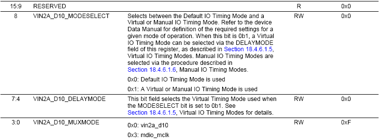

I want to confirm, the following two pins need to configure IODELAY parameters:
vin2a_d10
vin2a_d11
From ti_components / drivers / pdk_01_07_00_16 / packages / ti / boot / sbl_auto / sbl_utils / src / tda2xx / sbl_utils_tda2xx_iodelay.c view is not configured, the software is OK on the EVM board, running on our board, I did not Change the IODELAY parameter
But in actual operation, I read the following two registers have a value:
CFG_VIN2A_D11_OEN RW 0x00000106
CFG_VIN2A_D11_OUT RW 0x000000c8
I do not know how these values are written in?
