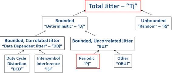

we refer to below link about Clock Input Electrical Data/Timing
www.ti.com/.../66ak2e02.pdf
       page:238 , According to the 156.25MHz Tj definition
About the Tj that will describe that 14Rj+Dj so the scope will always show “pk-pk” value.
Could you help confirm how to change the value from ps,rms to pk-pk?
thanks for your help.
