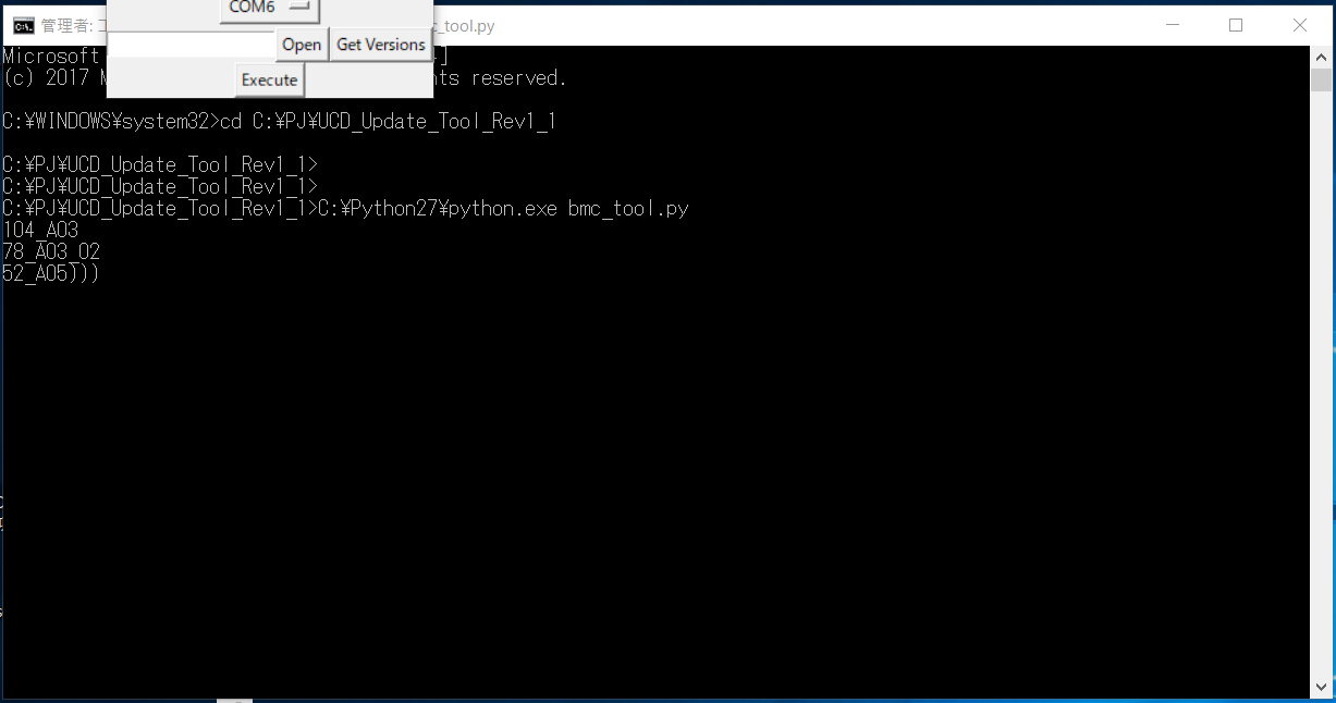

I bought a new EVMK2HX, but "soc power failure" was displayed on the LCD.
I tried the following UCD recovery procedure, but it did not improve.
The UCD recovery procedure is as follows.
processors.wiki.ti.com/.../EVMK2H_Hardware_Setup
1.Download (* A) UCD_Configuration_Standard_Release.zip referring to
"UCD Power Management Modules In-Field Update".
2.Copy (* B) UCD_Update_Tool_Rev 1 _ 1. Zip from the disk included in EVMK2Hx.
3.Install Python and PySerial referring to the pdf below.
processors.wiki.ti.com/.../Bmc_tool_ucd_update_guide_v2.pdf
4.I executed bmc_tool.py included in the compressed file of (* B) from the command line.
  C: \ Python 27> python bmc_tool.py
5.After selecting the BMC port from the UI screen of bmc_tool.py, press the Open button,
  Select the UCD 9244 _ 52 _ A 05. Txt included in the compressed file of (* A) and press the Execute button.
6.After executing the above procedure, waiting for a while,
  "Finished sending all commands" message was displayed.(No Error)
