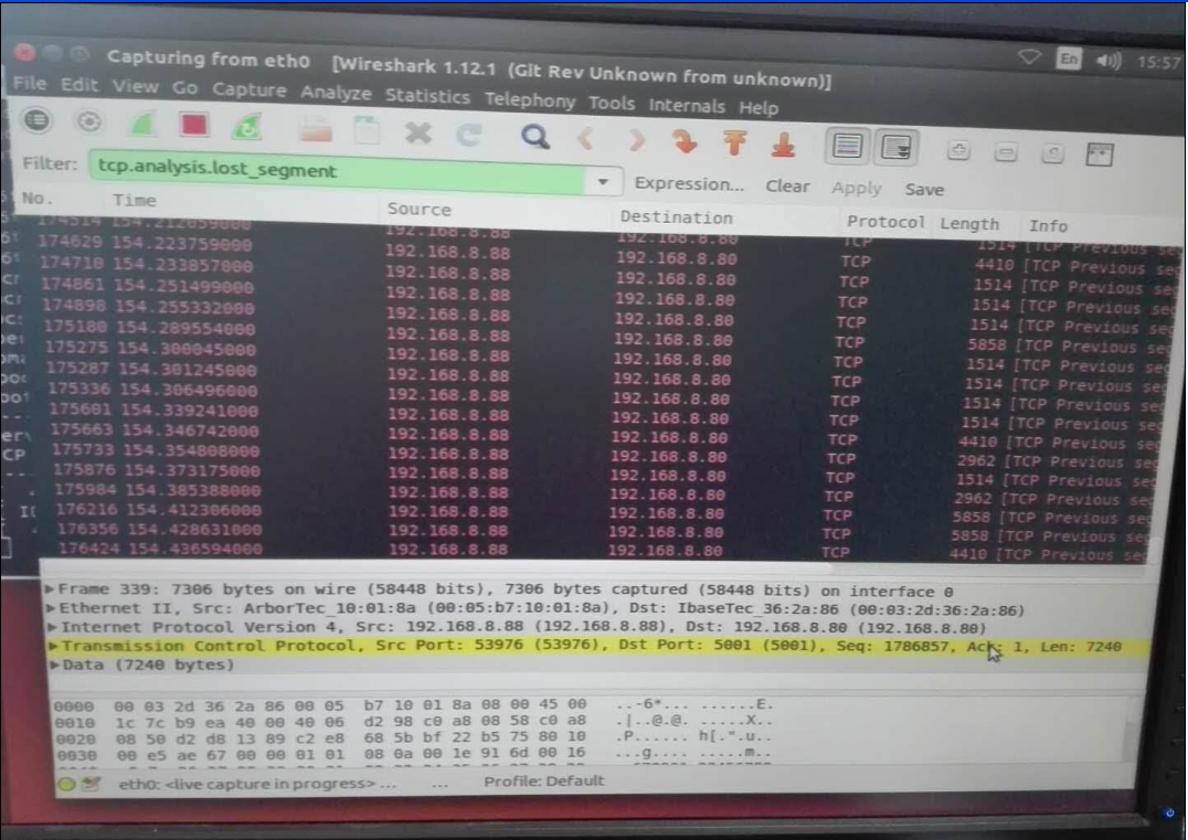

  • Hi Schuyler,
    Thank you very much for your  response.I ask Kent to post this question.
    I found that reduceing the  TCP window size of  iperf can reduce the data loss .
    the wireshark diagram is as blow

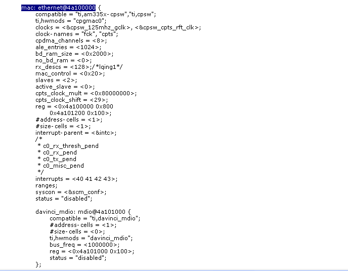

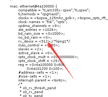

    I want to increase the size of skbuffer .am33xx.dtsi configuration:
    the function desc = cpdma_desc_alloc(ctlr->pool, 1, is_rx_chan(chan)) of the Davinci_cpdma.c (linux\drivers\net\ethernet\ti\Davinci_cpdma.c ) reture error.

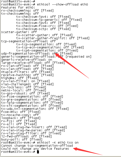

    how to use tcp-segmentation-offload?
    Could you give me some guidance on how to  change to driver to eliminate  the tcp retransmission issue, thanks a lot.
    My mistake earlier, I should specified that the TSO offload question I had was about what the host PCs are configured for and not the TI processor. The AM33x does not have any packet acceleration or offloading capability, which is what the ethtool results posted are showing.
    The question you are asking about concerning the number of rx descriptors in the DTSI file would apply here in terms of packet drops if the values were not equal to 0. These values were taken from the results of the ethtool -S was taken from the questions doc after the wireshark capture that was posted earlier.
    Rx Start of Frame Overruns: 0
    Rx DMA Overruns: 0
    So, the MAC/switch is not showing any packet drops. If the data loss is happening on the AM3352 perhaps the drop is happening further up in the network stack.

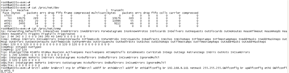

  • Hi Schuyler,
    before the transmission
    after the transmission
    Thanks for posting the screen captures.
    I originally asked to see this thinking that we see something on the TCP, then I remembered when operating as a bridge the kernel only forwards the packets and does not the TCP portion of the stack. I am looking for a way to determine where or if the am335x is dropping the packets.
