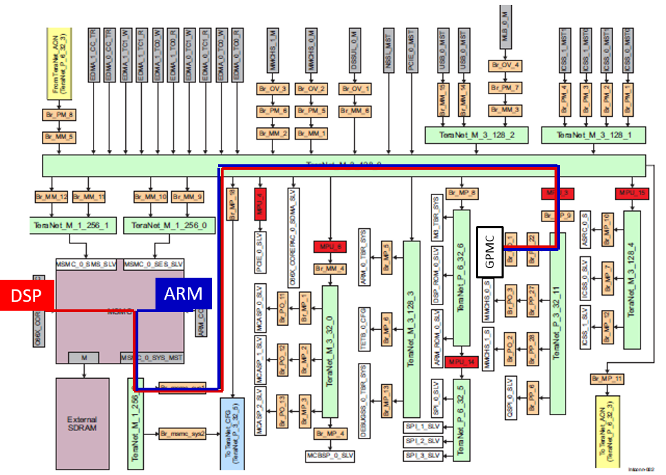

My customer want to access from ARM/DSP to GPMC.
It means ARM/DSP set register set.
I see Figure 3-2. TeraNet_DMA Master-Slave Connections.
I understand DSP access the GPMC through the Red line and
ARM access the GPMC through the Blue line
This understanding is correct ??
Best Regards
Hiroyasu
    There is no direct connection between C66x CorePack or ARM CorePack and GPMC.
    However GPMC is directly connected to MSMC_0_SYS_MST port via TeraNet. See Table 3-3. TeraNet_DMA Connectivity Matrix.
    So, yes, your understanding is correct. Both C66x & ARM can access GPMC through MSMC_0_SYS_MST.

  • Refer to Figure 3-2. TeraNet_DMA Master-Slave Connections & Table 3-2. System Interconnect Clocks and Resets:
    The path between MSMC_0_SYS_MST & GPMC goes through:
    MSMC -> TeraNet_M_1_256_2 -> Br_msmc_sys1 -> TeraNet_M_3_128_0 -> MPU_3 -> Br_MP_9 -> TeraNet_P_3_32_11 -> GPMC
    So TeraNet path is TeraNet_M_1_256_2, TeraNet_M_3_128_0 & TeraNet_P_3_32_11. According to Table 3-2:
    TeraNet_M_1_256_2 clock frequency is equal to CHIP_CLK1
    TeraNet_M_3_128_0 clock frequency is equal to CHIP_CLK1/3
    TeraNet_P_3_32_11 clock frequency is equal to CHIP_CLK1
    CHIP_CLK1 clock frequency is 600 MHz or 1GHz, as per Table 5-1. Supported Max Frequency of 66AK2G12 Datasheet.
