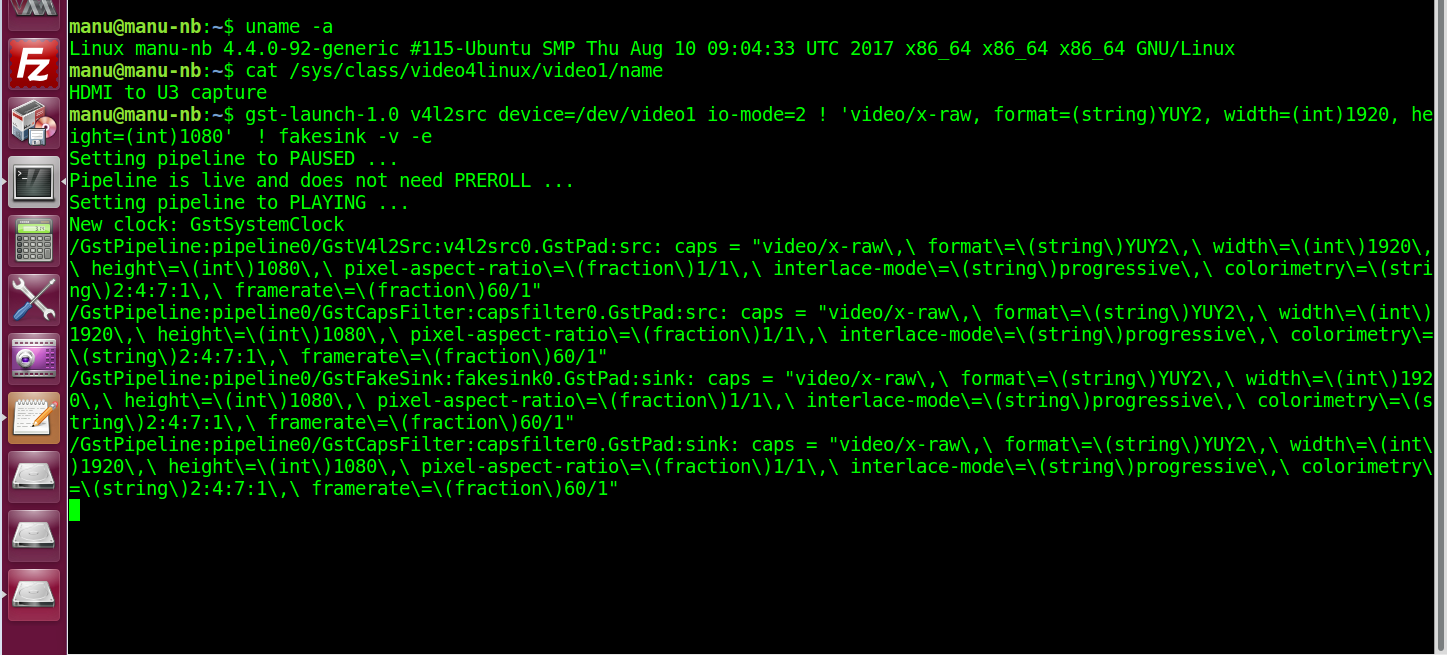

With AM5728 EVM over sdk 04.01.00.06, we have one USB 3 camera and the other of USB 2.
The former is running into problem as following (both logs attached).
Please advice.
Thanks.

root@am57xx-evm:~# gst-launch-1.0 v4l2src device=/dev/video1 io-mode=2 ! 'video/x-raw, format=(string)YUY2, width=(int)1920, height=(int)1080' ! fakesink -v -e
[ 78.789653] usb 2-1.1: reset SuperSpeed USB device number 5 using xhci-hcd
Setting pipeline to PAUSED ...
Pipeline is live and does not need PREROLL ...
Setting pipeline to PLAYING ...
New clock: GstSystemClock
/GstPipeline:pipeline0/GstV4l2Src:v4l2src0.GstPad:src: caps = "video/x-raw\,\ format\=\(string\)YUY2\,\ width\=\(int\)1920\,\ height\=\(int\)1080\,\ pixel-aspect-ratio\=\(fraction\)1/1\,\ interlace-mode\=\(string\)progressive\,\ colorimetry\=\(string\)2:4:7:1\,\ framerate\=\(fraction\)60/1"
/GstPipeline:pipeline0/GstCapsFilter:capsfilter0.GstPad:src: caps = "video/x-raw\,\ format\=\(string\)YUY2\,\ width\=\(int\)1920\,\ height\=\(int\)1080\,\ pixel-aspect-ratio\=\(fraction\)1/1\,\ interlace-mode\=\(string\[ 79.205888] xhci-hcd xhci-hcd.1.auto: ERROR Transfer event TRB DMA ptr not part of current TD ep_index 18 comp_code 1

  • Bin,
    This is the result against ubuntu.
    By the way, have you tested any ISO superspeed device against DCW3? I know BULK works.

    sink -v -e-1.0 v4l2src device=/dev/video0 io-mode=2 ! 'video/x-raw, format=(string)YUY2, width=(int)1920, height=(int)1080' ! fake
    [ 61.133795] usb 2-1.2: reset SuperSpeed USB device number 5 using xhci-hcd
    /GstPipeline:pipeline0/GstV4l2Src:v4l2src0.GstPad:src: caps = "video/x-raw\,\ format\=\(string\)YUY2\,\ width\=\(int\)1920\,\ height\=\(int\)1080\,\ pixel-aspect-ratio\=\(fraction\)1/1\,\ interlace-mode\=\(string\)progressive\,\ colorimetry\=\(string\)1:4:7:1\,\ framerate\=\(fraction\)60/1"
    /GstPipeline:pipeline0/GstCapsFilter:capsfilter0.GstPad:src: caps = "video/x-raw\,\ format\=\(string\)YUY2\,\ width\=\(int\)1920\,\ height\=\(int\)1080\,\ pixel-aspect-ratio\=\(fraction\)1/1\,\ interlace-mode\=\(string\)progressive\,\ colorimetry\=\(string\)1:4:7:1\,\ framerate\=\(fraction\)60/1"
    /GstPipeline:pipeline0/GstFakeSink:fakesink0.GstPad:sink: caps = "video/x-raw\,\ format\=\(string\)YUY2\,\ width\=\(int\)1920\,\ height\=\(int\)1080\,\ pixel-aspect-ratio\=\(fraction\)1/1\,\ interlace-mode\=\(string\)progressive\,\ colorime[ 61.376790] xhci-hcd xhci-hcd.0.auto: ERROR unknown event type 37

  • Manu Chen said:
    This is the (failure) result of 4.15-rc7 kernel against EVM. It disconnects before and after testing....
    Thanks for the testing.
    I just wanted to get clarification - the disconnect and re-enumeration before testing just happened automatically without you do anything to the usb dongle, right? And if you don't start the testing, will the dongle get disconnected and re-enumerated repeatedly forever?
  • Hi Bin,
    It disconnect once upon device installation before test starts. Not continuously re-disconnecting. Occasionally disconnection doesn't happen.
    Thanks.
  • Manu,
    I purchased the ExtremeCap UVC device and am able to replicate the issue which is similar to yours. I got the following message in the kernel log.
    [ 54.426473] xhci-hcd xhci-hcd.0.auto: ERROR Transfer event TRB DMA ptr not part of current TD ep_index 18 comp_code 1
    But when I add 'vmalloc=512M' in the kernel boot args, this message goes away.
    I am not a gstreamer expert, but I guess streaming 1920x1080@60fps YUV video requires much more data buffer which kernel doesn't provide by default. So you have to tune the kernel to ensure your application gets enough buffer.
    Please note that
    1. The gstreamer pipeline you provided directly stream the uvc video to fakesink in which case vmalloc pool affects the behavior, but I guess your project does some kind of video processing, then the pipeline is different. The video buffer might not come from vmalloc pool, could be from CMA or other DMA pool. You have to understand the pipeline your use on how the data buffers are allocated and how much is needed, so that you know where in the kernel to tune the buffer pool.
    2. 1920x1080@60fps YUV stream requires about 240Mbps data bandwidth on USB super-speed bus, which AM57x USB cannot achieve.
