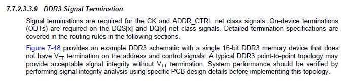

Hi all,
I would like to know about signal integrity analysis using the IBIS model of AM3352(ZCZ Package).
When conducting signal integrity analysis under the condition of ② below, it does not meet JEDEC standards.
Which method is right to do signal integrity analysis in ① and ②?
① Result of signal integrity analysis with only differential signals of DQS and DQS_N in ZCZ package.
② Results of signal integrity analysis of the differential signals of DQS and DQS_N and the data buses DQ0 to DQ7 in ZCZ package.
JEDEC which does not meet the standard is the following condition of 750 mV ± 150 mV.
