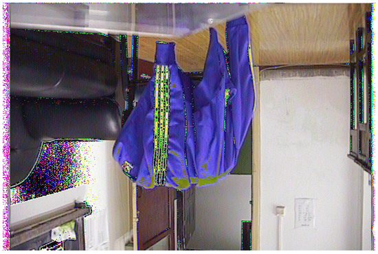

Now I just want to convert from YUV ( 4:2:2 ) to RGB,  but unfortunately , I encountered a problem, the converted result is bellow:
Obviously, there exists a lot of noise.

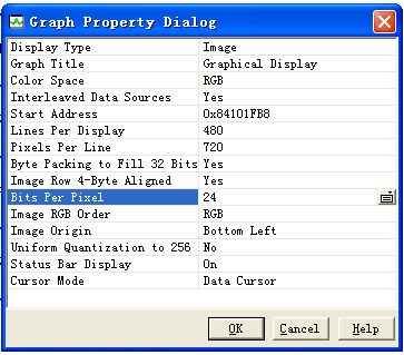

finally, I show the image  using ccs, the detailed steps are as follows:
View -> Graph -> Image...

  • Hi Zhiqiang,
    I am not sure where you got the coefficient
       RGB[k+j].r = (298*(Y[k+j]-16) + 409*(Cr[ (k+j) / 2] - 128) + 128) >> 8;
       RGB[k+j].g = (298*(Y[k+j]-16) - 208*(Cr[(k+j) / 2] - 128) - 100*(Cb[(k+j) / 2] - 128) + 128) >> 8;
       RGB[k+j].b = (298*(Y[k+j]-16) + 516*(Cb[(k+j) / 2] - 128) + 128) >> 8;
    Would you be able to try
    R = (1.00000 ´ Y) + (0.00000 ´ (Cb – 128)) + (1.40200 ´ (Cr – 128))
    G = (1.00000 ´ Y) – (0.34414 ´ (Cb – 128)) – (0.71444 ´ (Cr – 128))
    B = (1.00000 ´ Y) + (1.72200 ´ (Cb – 128)) + (0.00000 ´ (Cr – 128))
    or
    R = (1.00000 ´ Y) + (0.00000 ´ (Cb – 128)) + (1.37110 ´ (Cr – 128))
    G = (1.00000 ´ Y) – (0.33690 ´ (Cb – 128)) – (0.69820 ´ (Cr – 128))
    B = (1.00000 ´ Y) + (1.73240 ´ (Cb – 128)) + (0.00000 ´ (Cr – 128))
  • In addition to Paul's comments...
    This looks like you have overflow occurring somewhere.
    What are the structure types for "PIXEL_COLOR" ?If these are not int then you will get overflow and the comparison against ">255" will never be true.
    Additionally I would look at the precedence of the calculation step. Sometimes there are implicit type conversions which may be causing issues.
    What you are seeing is not actually noise, but roll-over on some of the color channels. This type of 'noise' appears when you have shaded regions which have color components which are close to either maximum or minimum values and you have not correctly handled roll over and calculation ranges.
    What are the intermediate values of "RGB[k+j].r" just after the calculation?
    Try putting a break point inside the range checking code to make sure that it does get there at some time.
       if(RGB[k+j].r > 255)
        RGB[k+j].r = 255; //Set break point here
       else if(RGB[k+j].r < 0)
        RGB[k+j].r = 0;
    BR,
    Steve
  • Hi Steve and Paul.Yin
    I am sure that the roll-over has happened.
    Now I have solved the problem.
    Thank you!
    Zhiqiang
