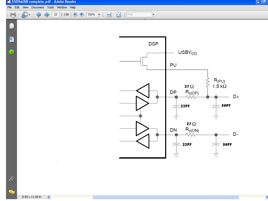

    Thank for reply... Now i connected 12MHZ crystal accross X1 and X2, but still it is not recognised....  I configured GPIO[3:0] =0010b (typed wrongly in last post).... What are area should i troubleshoot?....
    Circuit diagram:

    Following were the supply details...
                                              USBPLLVDD=1.6V
                                              USBPLLVSS=0V
                                               USBVDD=3.3V
    I have connected only D+ and D- to the USB pin.... PC does not recognise the chip....

  • Pradeep,
    The connections, clock speed, and BOOTMOD are correct. There is an application note that might help you. Please look over:
    Using the TMS320VC5506/C5507/C5509/C5509A USB Bootloader
    http://focus.ti.com/lit/an/spra840c/spra840c.pdf
