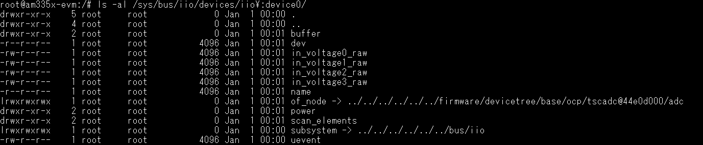

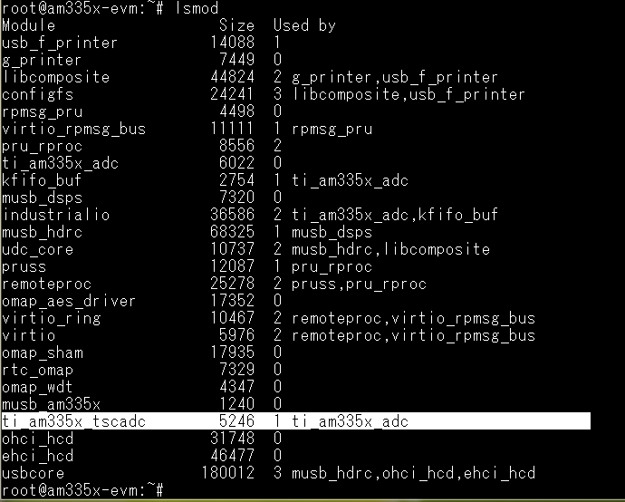

    I am already using a 4 channel ADC.
    However, there is a problem if you modify the dts further to use the touchscreen.
    - Am335xx.dtsi
    tscadc: tscadc@44e0d000 {
     compatible = "ti,am3359-tscadc";
     reg = <0x44e0d000 0x1000>;
     interrupt-parent = <&intc>;
     interrupts = <16>;
     ti,hwmods = "adc_tsc";
     status = "disabled";
     tsc {
      compatible = "ti,am3359-tsc";
     am335x_adc: adc {
      #io-channel-cells = <1>;
      compatible = "ti,am3359-adc";
    - 4 channel ADC dts : no problem
    &tscadc {
     status = "okay";
     clocks = <&adc_tsc_fck>;
     adc {
      ti,adc-channels = <0 1 2 3>;
      io-channels = <&am335x_adc 0>, <&am335x_adc 1>, <&am335x_adc 2>, <&am335x_adc 3>;
      io-channel-names = "AIN0", "AIN1", "AIN2", "AIN3";
    - 4 channel ADC + 4 wire touchscreen dts: problem
    &tscadc {
     status = "okay";
     tsc {
      ti,wires = <4>;
      ti,x-plate-resistance = <200>;
      ti,coordinate-readouts = <5>;
      ti,wire-config = <0x00 0x11 0x22 0x33>;
      ti,charge-delay = <0x400>;
     adc {
      ti,adc-channels = <0 1 2 3 4 5 6 7>;
    Segment error occurs in my driver that I used without problems.
    How can I use 4-wire touch ADC and general 4-channel ADC together?
    Thanks a lot for your help.
  • I finished with your help
    thank you very much
