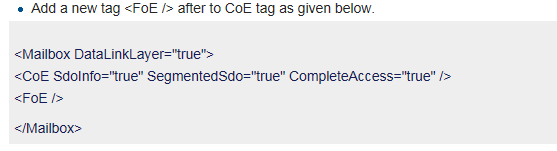

I am trying to update the application using FoE by following the instructions mentioned in the below link.

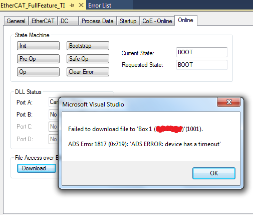

But I am getting an error on ICEv2:  "Failed to download file to Box1.........ADS Error device has a timeout". I have attached the screenshot of the error.
I am using processor_sdk_rtos_am335x_4_00_00_04 and PRU-ICSS-EtherCAT_Slave_01.00.04.02. I have generated the ESI file using SSC tool and followed the instructions mentioned for building the ethercat_slave_full_AM335x_arm project. The project is working fine to do all the communication with TwinCAT and I can exchange PDOs in OP mode.
Now I wanted to use the FoE feature for upgrading the application remotely. But I am facing this issue.
