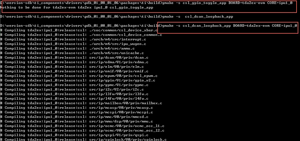

  • Hi Cesar,
    PDK has CSL DCAN loopback example (csl_dcan_loopback_app) that can be run on IPU.
    In order to build this example from Vision SDK please refer to: processors.wiki.ti.com/.../PDK_FAQ
    Rishabh

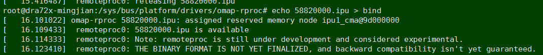

    i make it and generate the csl_gpio_toggle_app_ipu1_0_release.xem4
    i copy it to $rootfs/lib/firmware and ln -s csl_gpio_toggle_app_ipu1_0_release.xem4  dra7-ipu1-fw.xem4
    run the system and execute:
    # cd /sys/bus/platform/drivers/omap-rproc/
    # echo 58820000.ipu > unbind
    # echo 58820000.ipu > bind
    the phenomenon:
    I don't know if he works normally, and the gpio pin no change found.
    Cesar

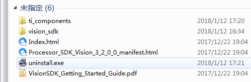

  • Hi Cesar,
    Vision SDK has docs\TrainingSlides folder which contains different training slides.
    CCS_Debug_Trace.pdf document contains steps on how to run VSDK application using CCS.
    Rishabh
  • Hi Rishabh,
    the sdk doc dir only this:
    take the liberty of asking, are you in America now?
    Cesar.
  • Hi Cesar,
    We are referring to two different SDKs: Processor SDK Vision and Processor SDK Linux.
    I will ask the Processor SDK Linux expert to help you.
    Rishabh

  • Hi Rishabh,
    i download the VERSION SDK, and next step,how test gpio example and connect the dra725-evm board;
    Cesar
  • Hi Cesar,
    Follow the below instructions:
    1. Go to folder ti_components\drivers\pdk_01_08_01_06\packages\ti\build.
    2. Give command "make -s csl_gpio_toggle_app BOARD=tda2ex-evm CORE=ipu1_0". Make sure that compiler path/PDK path is set correctly in Rules.make.
    3. This will create csl_gpio_toggle_app_ipu1_0_release.xem4 in <pdk_rootdir>\packages\ti\binary\csl_gpio_toggle_app\bin\tda2ex-evm.

  • Hi Rishabh,
    thank you for your reply,
    i don't find make compiler tool on windows
    Cesar
  • Hi, i use the gmake tool
    make the csl_gpio_toggle_app is nothing, but it'ok that make the dcan
    Cesar
  • Hi Cesar,
    I checked the PDK code base. csl_gpio_toggle_app is validated only for A15 core 0.
    Kindly try the build by using CORE=a15_0. Remaining build command is same.
    If you need M4 binary first you need to port this app on M4.
    Rishabh

    i find our product(dra72x) is not supported the version sdk,we use the sdk 'ti-processor-sdk-linux-automotive-dra7xx-evm-03_02_00_03';
    the sdk have 'make ipc_ipu' , build out './component-sources/ipc_3_43_03_05/packages/ti/ipc/tests/bin/ti_platforms_evmDRA7XX_ipu1'
    to load the example 'messageq_single.xem4'
    # cd/sys/bus/platform/drivers/omap-rproc/
    success load:
    [ 99.666729] remoteproc0: Booting fw image dra7-ipu1-fw.xem4, size 3910020
    [ 99.674012] omap-iommu 58882000.mmu: 58882000.mmu: version 2.1
    [ 99.693495] remoteproc0: remote processor 58820000.ipu is now up
    [ 99.700611] virtio_rpmsg_bus virtio0: rpmsg host is online
    [ 99.707160] remoteproc0: registered virtio0 (type 7)
    [ 99.713517] virtio_rpmsg_bus virtio0: creating channel rpmsg-proto addr 0x3d
    but i want get the gpio state from ipu to A15, how operate on ipu; i find the pdk example, but load it can't work;
    Cesar
