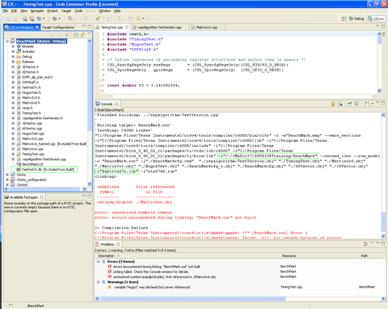

    Further to my previous post, profiling of my code has narrowed down my speed problem to a few double precision divides. Specifically, they are reciprocals. And I think that they are taking about 900 cycles each to complete.
    I noticed that the fastRTS67x library has a double precision reciprocal function. I have downloaded this but I cannot link it to my project in CCS4. Can anyone help? Here are some details:
    I have copied ‘fastrts67x.h’ and ‘recip.h’ and ‘fastrts67x.lib’ to my project folder and ‘#include’ the dot h files in my source. In Build settings I add reference to the dot lib file.
    The project compiles OK but I have unresolved symbols on the linking stage: as if it cannot link to the fastRTS library:
    <Linking>
     undefined       first referenced
      symbol             in file
     recipdp(double) ./Matrix6x6.obj
    error: unresolved symbols remain
    error: errors encountered during linking; "BenchMark.out" not built
    I read in some Forum posts that you have to specify the link order:
    http://e2e.ti.com/support/microcontrollers/tms320c2000_32-bit_real-time_mcus/f/171/p/42613/149124.aspx#149124
    http://e2e.ti.com/support/development_tools/code_composer_studio/f/81/p/63363/227867.aspx#227867
    I have tried this, but I can find no reference to ‘Generated Linker Command files’ in the CCS4 Build Settings page.

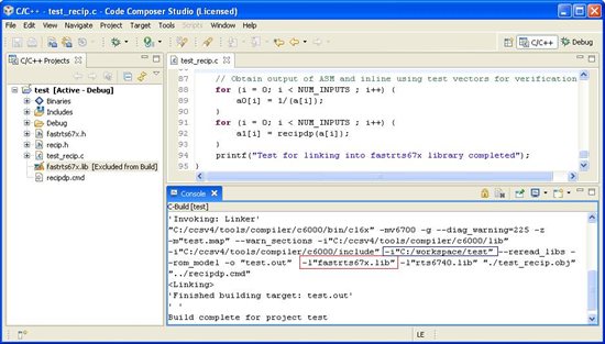

  • John,
    For your reference here is a test project that I created to show the usage of recipdp in  fastrts67x library. The project replicates what you are trying to do by copying over the files from the fastrts library.
    6874.test.zip
    Let us know if this helps you figure out the issue that you were seeing on your project.

  • Rahul,
    Thanks for your response. I did not have “${PROJECT_ROOT}” in the File Search Path for the linker – however, I had included the specific file (including the file system path) in the --library section. Putting “${PROJECT_ROOT}” on the search path yields the same results, i.e. the library is still not found by the linker. Note that “${PROJECT_ROOT}” is NOT included on the search path for the compiler – I guess that this is implied? Here are the ‘All Options:’ for the original way I set it:
    -m"BenchMark.map" --warn_sections -i"C:/Program Files/Texas Instruments2/ccsv4/tools/compiler/c6000/lib" -i"C:/Program Files/Texas Instruments2/ccsv4/tools/compiler/c6000/include" -i"C:/Program Files/Texas Instruments2/bios_5_40_02_22/packages/ti/rtdx/lib/c6000" -i"C:/Program Files/Texas Instruments2/bios_5_40_02_22/packages/ti/bios/lib" --reread_libs --rom_model
    I’ve never looked at this before but look: there appears to be no reference to my file. I checked this twice, it is definitely in the ‘File Search Path’ window under --library, but doesn’t appear in ‘All Options’. Here they are if I, instead, put “${PROJECT_ROOT}” in the search path:
    -m"BenchMark.map" --warn_sections -i"C:/OMAPL137/DSPBIOSTraining/BenchMark" -i"C:/Program Files/Texas Instruments2/ccsv4/tools/compiler/c6000/lib" -i"C:/Program Files/Texas Instruments2/ccsv4/tools/compiler/c6000/include" -i"C:/Program Files/Texas Instruments2/bios_5_40_02_22/packages/ti/rtdx/lib/c6000" -i"C:/Program Files/Texas Instruments2/bios_5_40_02_22/packages/ti/bios/lib" --reread_libs --rom_model
    The path is there this time, but the library is still not found. The additional steps I mentioned were because the other threads I quoted in my previous post said that it was important to specify the link order – specifically that the fast library was linked before the standard one. The posts mentioned “Generated Linker Command Files” as an option for link order, but I could not find that.

  • John,
    Sorry to know that you have to face this issue when infact you seem to be doing all the right steps to link the fastrts library. I have few more suggestions that you can try and see if that resolves your issue. Right click on your project and from the "Add files to project ", add the fastrts67x library to your project(if it doesn`t exist already). Once you see the library in the project, right click on the library and pick the "Exclude the file from Build" option and try to rebuild the project and notice if you see the library is being linked in the linking process. Here is the snapshot of what you should be seeing in the project and the console window.
    If this does not resolve the issue,the only way I see to sort this is for you to replicate my project for which you might have to update your version of CCSv4 as the version that you are using is a pretty old one. You can do this by going to the "Help" ->"Software Updates"->"Find and Install".

  • Hi Rahul,
    Thanks for the advice. I tried your suggestion but to no avail. I didn't realise I could paste screen shots before, so I have included the result of my latest attempt below. I have highlighted the areas you said to look for - I think that they are all present and correct. I am now attempting to download the latest version of CCS, but it is taking a while as I have a relatively slow connection. Also, the first attempt at download resulted in a corrupted zip file. So I am trying a second time.
    The matrix inverse code sounds interesting, I will check this out once the fastRTS problem is resolved, it may lead to even more speed increase.
