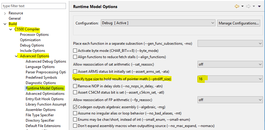

  • Sadeq,
    Please try changing the --ptrdiff_size in your project to 16 as shown below and rebuild
    Lali
  • thanks for replying
    I made the changes and recived error below.

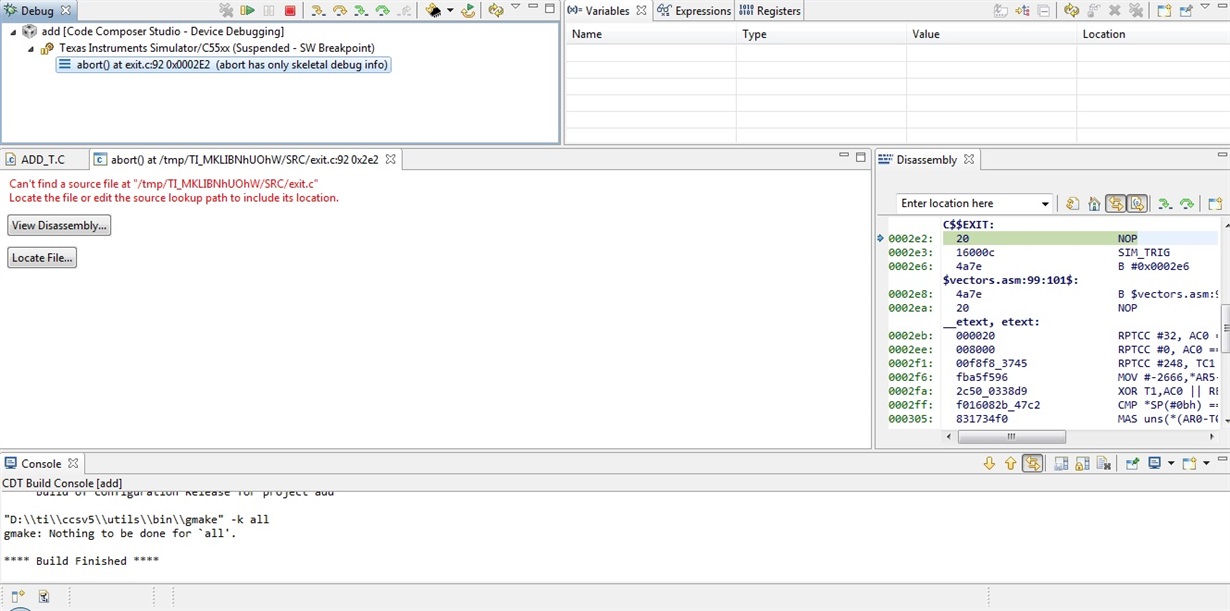

    yes i test it with large memory model but it didn't work. I change the device model to "USBSTK5515" and problem solved. I think 5509 is not supporting the huge memory model. but there is a new error comes out in debugging  and its:
    Can't find a source file at "/tmp/TI_MKLIBNhUOhW/SRC/exit.c"
    Locate the file or edit the source lookup path to include its location.
  • Sadeq,
    That error isn't very descriptive.
    Does this error occur during run-time? Can you put break points in your code to see where it fails?
    Lali
  • thanks for your patient Lali
    I don't set any breakpoint and its not occur during run-time. it's happened on the beginning of the run time. By the way i just ignore it and everything is just fine. how ever it seems this library (dplib) is use less for cv5509 because 5509 has not supporting huge memory model.
    Is there any way to use this library for 5509 processor? for instance change memory model in "dsplib.lib" file from huge to large or small memory model?
